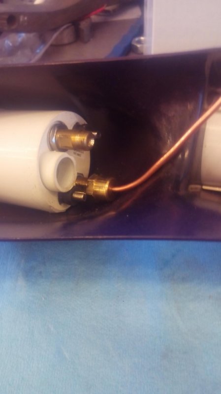

Finally making some headway. Got the wiring figured out on the fan clutch. Got the tubing mounted to my gauge, had to put it on and then slide the gauge into the hole.
