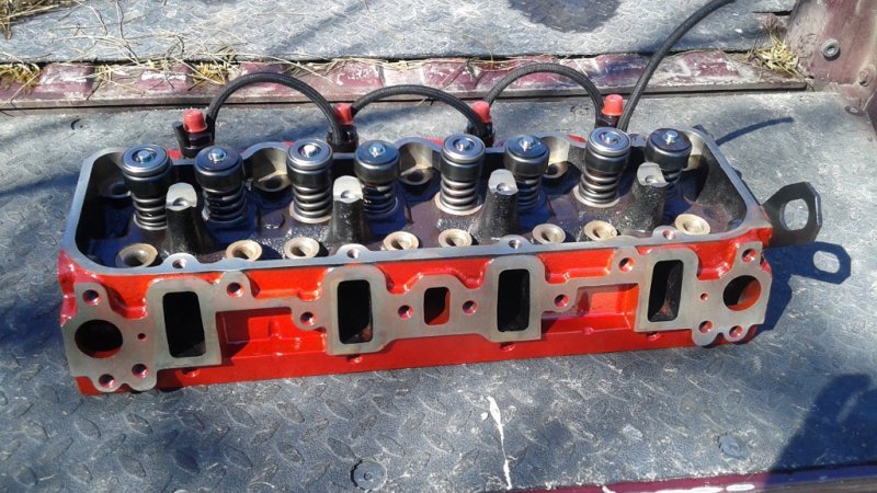

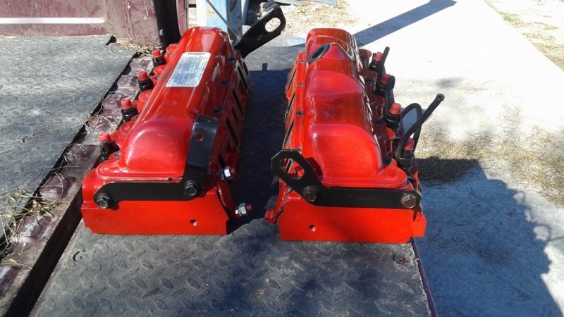

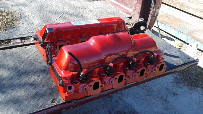

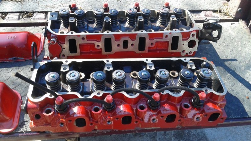

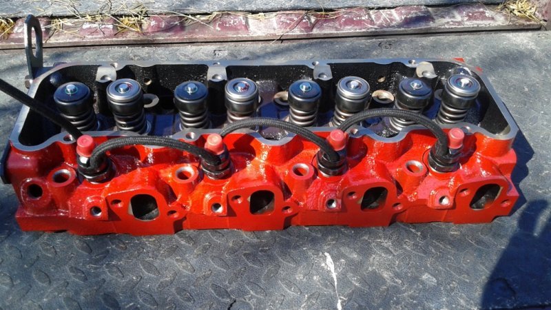

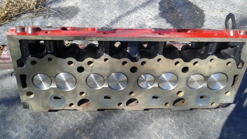

I know this isn't much of an update, but I'm going to update you anyway.:D I got the heads painted, but I did it the lazy way. I just found a spray can that match my color closely. I don't generally use spray bombs, as a good professional paint with hardener holds up much better, but to pull out my gun for a pair of heads seemed silly, so some good ole DupliColor made short work of it. You can see the color is a good match with the engine, as I didn't repaint the valve covers.
I went to pick up my head gaskets at Orielly's today, but they didn't have them in stock, so they will be here in the morning.

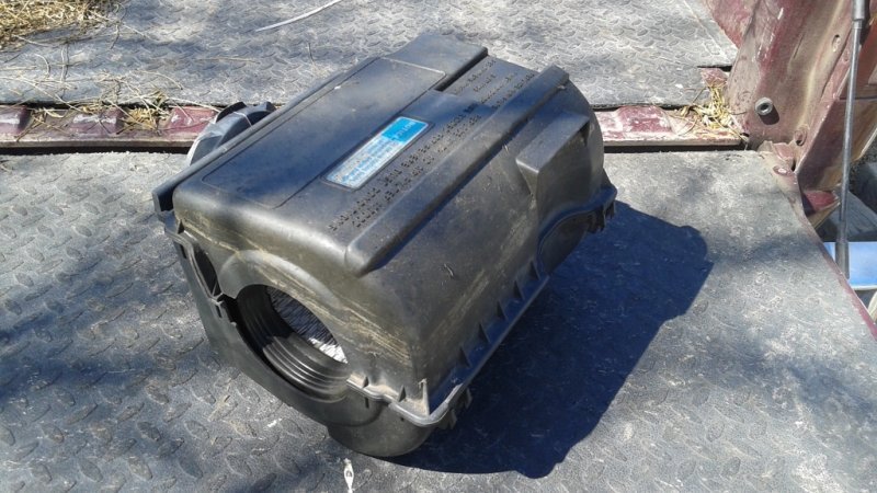

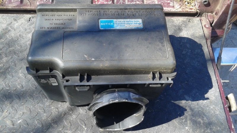

I also managed to pick up a K47 air box for next to nothing, which will be nice once I get it back together.
Matt

I'll be curious to see how that turns out Leroy, as I wouldn't think it would leave a very nice finish, particularly on the sheet metal, like the valve covers.
I pasted that emoticon, as none of the ones we have were fitting.:D
Matt
I was at a swap meet this weekend and there was a POR 15 vendor there. He had a sample of their engine paint there that had been applied with a foam brush. It looked fine for the casting but not the finish I wanted for the sheetmetal. I'm planning on doing Dupli Color rattle cans on mine.
Por-15 does not look bad at all with a brush. My neighbor used it on his transfer case he rebuilt. He then painted over it with that hammer paint. I used it on some banshee parts that were rusting. We both used a cheap brush. When done it looked good. Did not have the brushed on look. I want to use POR-15 on my frame. One day, when I have the money. :rolleyes:
