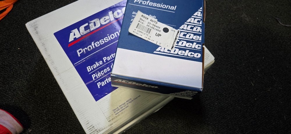

Got the brakes ordered for the Yukon. Went with all ACDelco Gold Professional coated rotors and pads. Really hope to get some extended intervals with these over the aftermarket brands.
Also got a set of Motorcraft rotors and pads for the MILs 04 Ford Explorer.
Make sure to burnsish them - (the slow controlled stop / rest drive). That first drive makes the biggest difference there is in life of pad and rotor (also shoe/drum).
