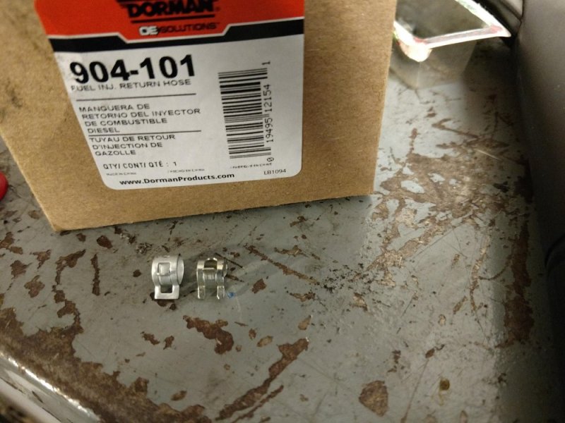

Getting new injectors of the IP builder's recommended pop pressure put in. Haven't hit the starter yet due to rebuilding the AC and moving the trans oil cooler to behind the condenser.
A shout out to Dorman for the 904-101 kit with an improved injector return line clamp. New Clamp Design on the left (pic old OEM style clamp on right) doesn't require you to get both the fing tabs in the pliers to put on. About damn time! It's the little things sometimes. (Do not get me started on the braided push on soaked in fuel cracked up leakers that claim to be clampless easy. If it's worth doing: do it right the first time esp. under the turbo...)

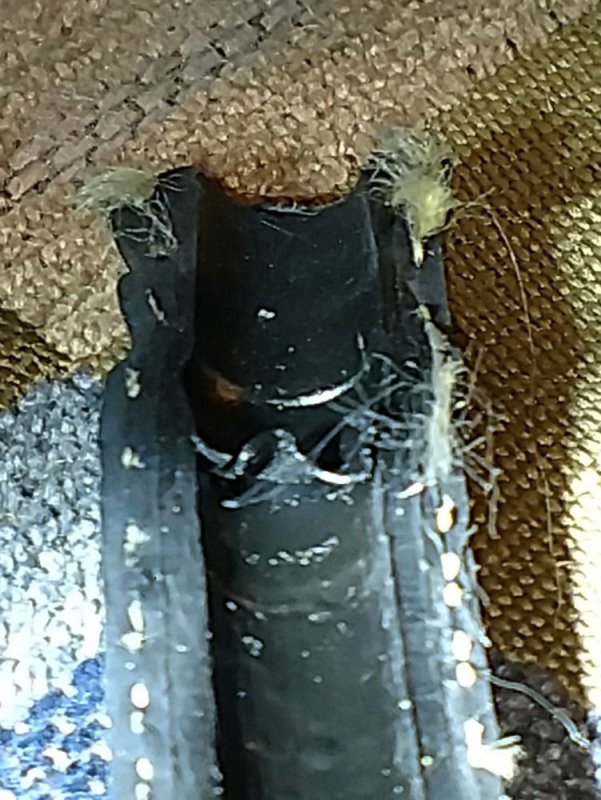

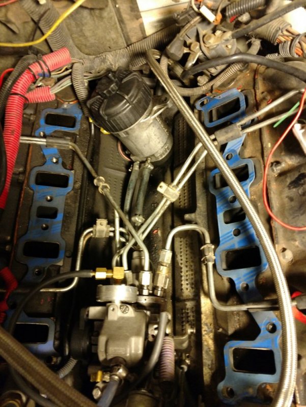

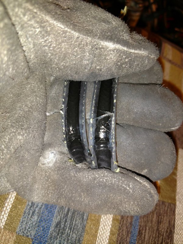

Gotta say it here man..
The new standard.
Stainless steel “T” that screws into the ip. Solid stainless tube from ffm to the T. And the other side of the T feeds pressure gauge.
I know you hooked up pressure gauge to the drain fitting location. This rare issue is perfect reason I always want the gauge tapped of the IP fitting. At least the headache quest is over. (I hope).
Seen this before, just not usually right at the ip fitting.
Was that hose sae30r9? As much alcohol as they put in our fuel, it wouldn’t surprise me if it even destroyed the good stuff.

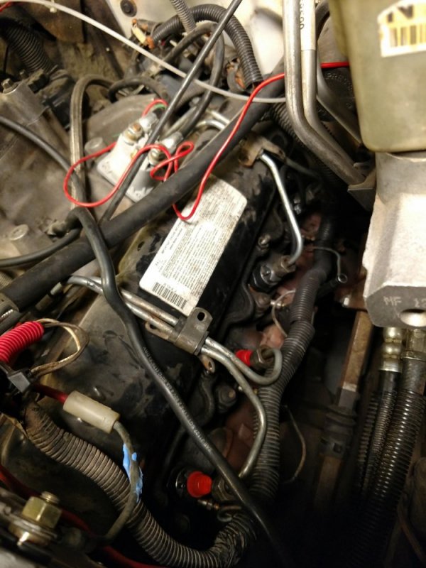

Timing pinned max advance, under 10 psi boost, under 1000 EGT (fing embarrassing.) And still slow accel snap test with misfire. @Will L. Reminded me to put a clear line on to ck for air. This only showed cloudy during a snap - aka vapor lock. I hope the screen in the IP nose isn't clogged from this hose. I will know when it cools down enough to open garage doors to run it. AC on in garage...
