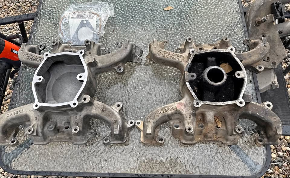

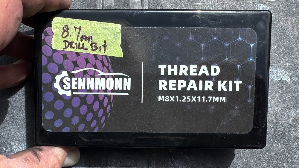

I have a lower intake with an upper intake bolt hole busted out.
I will, someday, get out the aluminum arc rod that I use, and the oxy/acetylene torch, knock off a fair amount of the flux from the rod and play with building that bolt flange back out then drilling and tapping new threads through it, just to see if I’ve got enough technique to make it work. 🤷😹

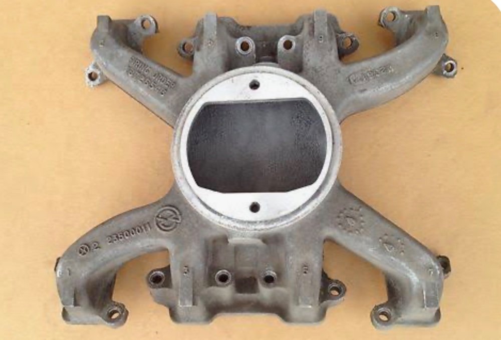

Pictures of a butchered out upper and lower intake? Or do you want to see the pictures of the spacer and its morphing through development...from idea and concept, through wooden mock ups and a rough cut out by a local machinist, to a CNC'd piece that was once anodized, sorry, Purple?
The butchered unit didn't get pictures but, the spacer development was a 6 page thread. Some of the pictures are small but, you can zoom as desired. A lot of people from back then aren't here anymore. Just AKDiesel Driver I think is still active on the forums.
