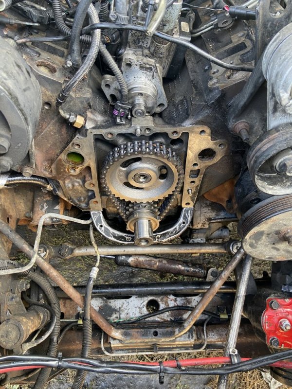

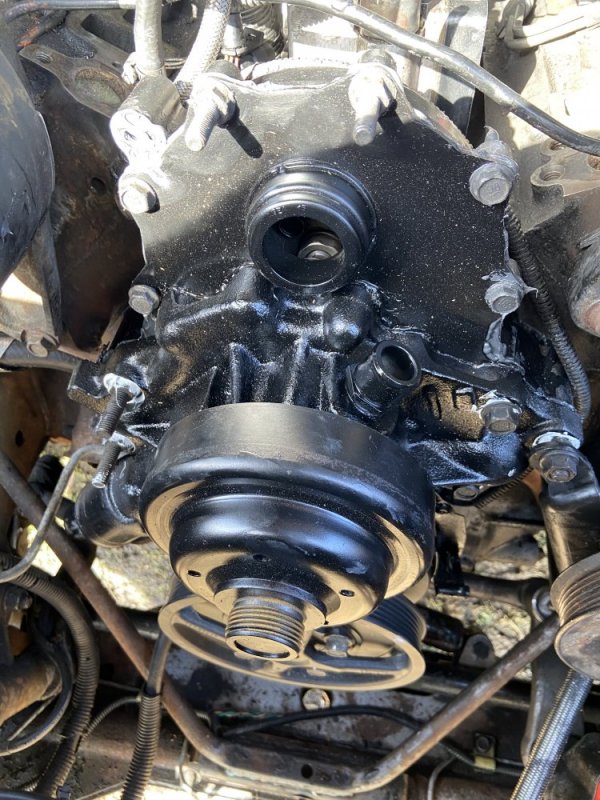

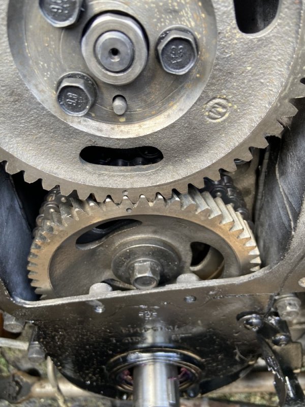

After I got done with the tuneup and timing chain components on My 6.5, it would not start.
