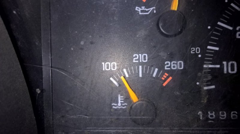

So, In my old wore out motor, I used to run a consistent 175*.
After putting in the new motor (in my sig), I'm running about 134*, which seems awfully cool to me.
It will slowly go up to about 155* when I accelerate or up hills, but just barely. And I did get it up over 210* but it took me towing a 26' fifth wheel 65 - 70 mph up a grade in a head wind to do it. (No complaints there and more cooling mods will help that even more.)
Any thoughts on this? Is this normal/ok?

To cool. In both ways. I think your thermostat is stuck wide open. I think your loosing about 10% power and 20% mpg.

You know the exact temp how? The factory sender and gauge are not exactly calibrated.
Dang, it's a pretty new 185* AC Delco.

So the old thermostat did that also?

Well, I looked through my records and can't find when I put the thermostat in but I'm sure it was in the old motor too.
So, try switching the thermostat, put please take pics of the tstat if it is stuck open. I would really like to understand how to obtain what you are doing.

I do have a 195* thermostat that I could put in. I'll try to get that done today or tomorrow with pics.
Same temp sender from the old engine? That can make a difference as well, if you have good heat at 135* F, I think the reading is off. If it is off I would be worried about the 210* F reading.

I think the sender is the same though. I changed all that stuff on the old engine to be ready for towing and just moved them to the new engine because they were so new.
I'll start with the thermostat first and then change the sender if it doesn't change anything.

I know of 2 trucks run that cool, but it was drivers complaining in the winter time about poor heater performance. Found bad tstat and swapped it, but it was other guys in the shop that fixed them while I was gone. I wasn't convinced the 2nd time wasn't a joke on me because I tried to find the 1st one but couldn't.
Put an OEM t-stat in it. The OEM stat has a rubber seal that seals the poppet to the stat housing to prevent any coolant flowing past before it opens. What normally happens is the rubber cracks and allows coolant to leak by, and then this happens. Just because the stat was new, does not mean it was actually NEW. If the stat was old new stock, then the rubber is also old, and would not hold up long leaving you with this problem not long after it was put in.
Hmmm... It is an AC Delco from rock auto but it didn't have a rubber ring with it. Come to think of it, none of my thermostats have had a rubber ring.

The IR temp guns are pretty cheap now. I would borrow or buy one and check the temps. You can't trust the gauge reading as gauge itself, wire, connectors, grounds, and temp sender can all flake out pretty bad.

You're running the aftermarket ac delocos, not the correct reccomended oem type ac delco with the correct bypass blocker spring tension. If you look at RA, the one you want is the one for $26.79.

IR gun is a good idea. Where would be the best place to lay the IR point? Top of the radiator? Bottom? Heads?

Max temp hit about 155* per the gauge. On the way down, it cooled quickly to ~125 - 130*, so pretty much back to "normal".

Got it Ferm, I'll put the 190* back in and see if there is a change, then I'll get that $26.79 unit coming if not.
I think your dash gauge is off. I think you should get a code if it was only 135F. I think it is suppose to reach 160F within 10 minutes of start up or sets code. When my stat stuck open it ran cool and set the check engine light.

Us db2 folk don't get that. The only thing the 2 pin thermostat feeds is cold advance & high idle solenoids.
Which is another way to verify temps: once at full temp, unplug the two connected wires on the front of IP and if engine idle goes down a bit- both temp sensors would have to be bad faulting low.
