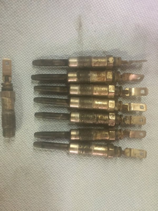

I’m done with bosch glowplugs
20,195
40,089
Only recomending or using AC DELCO 60 G from now on.

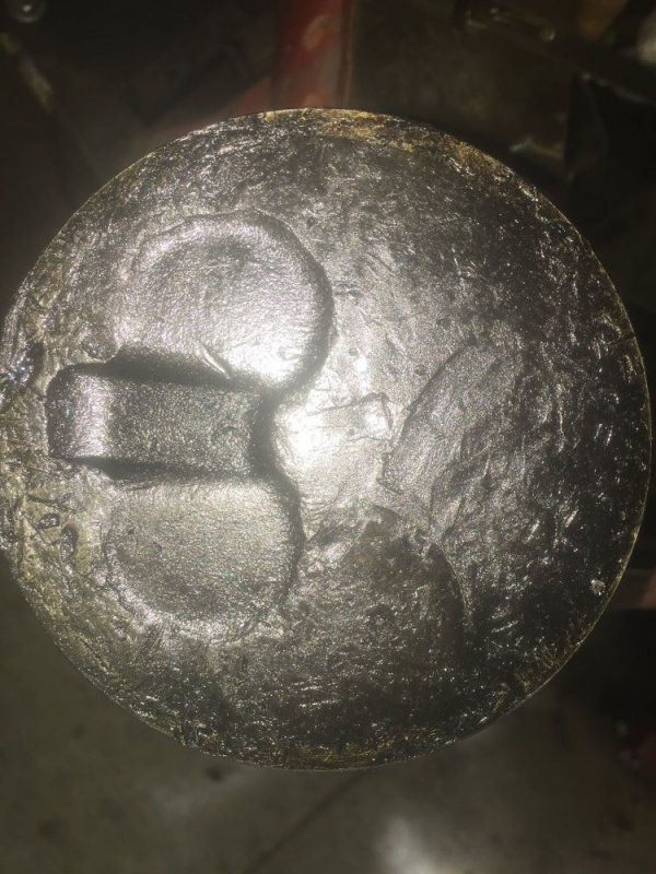

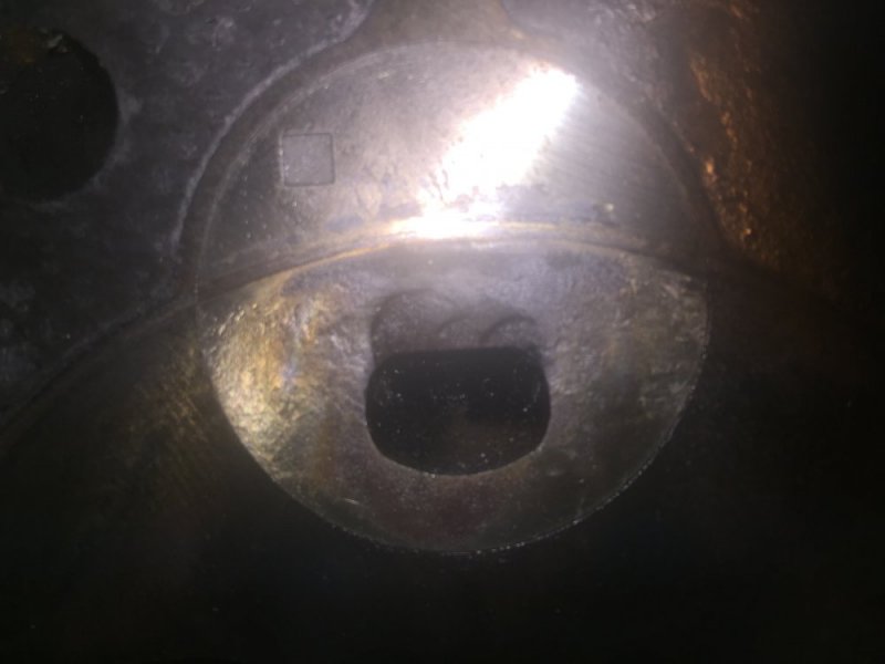

The bosch 80034 is off my list. I only use or recommend the self regulating in order to avoid the annoying swelling, but more importantly the element braking off and destroying engine. Which leads me to...560045600556006
Maybe 10,000 miles on the glowplugs. I never found the element. Can’t see any head damage of valve damage. Turbo seems ok.
Called bosch warranty, have a claim filed. Waiting for return call.
I was replacing pistons anyways, so no real loss other than could have sold a set of matching optimizer pistons for $. Also the damaged square precup. I am going to put in my diamonds anyways for this build. But out the parts precups to put together the gm block.
Annoying to try buying top quality and it fails.
Damn... Ironically one of my questions for y'all was going to be best glow plugs I guess I know now... Sorry that happened to you delisa didn't do any real damage aside from to your pocket
I ordered a set of the Bosch duratherm glow plugs, and had 4 connector flat pins fall off the glow plug. Can´t say I was very impressed by them..
Soooo...a/c Delco it is....now onto injectors..lol...is it possible to have that head resurfaced??.. seems like somebody told me you could have them redone
I think Svein is about the 6th person I herd say the electrical connection falling off.
Bosch did ask when I spoke to them where they cane from wanting to make sure not ebay- as there are some knock off ones out there.
They gave me a warranty claim number and were supposed to follow up, frok a different department. I filed the claim the same day I started this thread. Haven’t heard anything yet...
I´ve kept the bad glows somewhere - I was thinking I was gonna try to return them, but in the end of the day I can´t be bothered. I ordered mine via RockAuto, so maybe it´s worth a shot? I´m kind of thinking it´s gonna cost me more to ship them back to the US than the refund would be.
It´s really irritating though - In the end of the day, it cost me more than to buy them all at the local dealer. They sell the rx glow plugs, it turned out. He said they were self-limiting, so I´m hoping that´s true. I haven´t really read anything to prove it, though..
