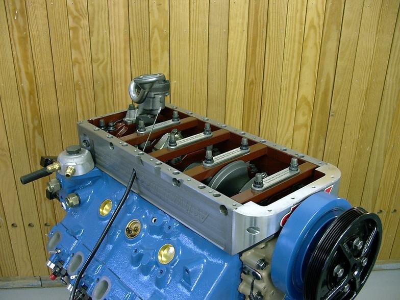

If you really want a serious girdle look in to powered by design's build from 00. I've been wanting to contact him and see what it would cost to build another one...
http://www.poweredbyd.com/6-5L-Turbo-Diesel-Project.html
