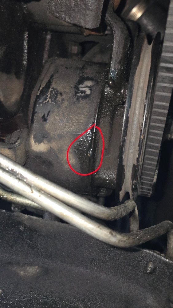

Check the pitman shaft seal. that looks to be right in that area. if you see everything oily, get you a can of brake cleaner spray and clean everything up and drive it. then look to see what is getting wet with the oil.

That is a simple fix. it's the o-ring on the reservoir to the pump. you'll need a puller to remove the pulley off the pump to get at it. pull the pump off and open it up on the bench. I would say rebuild it replacing the shaft seal too while you have it off. there are several youtube education classes out there on how to rebuild the pump.
