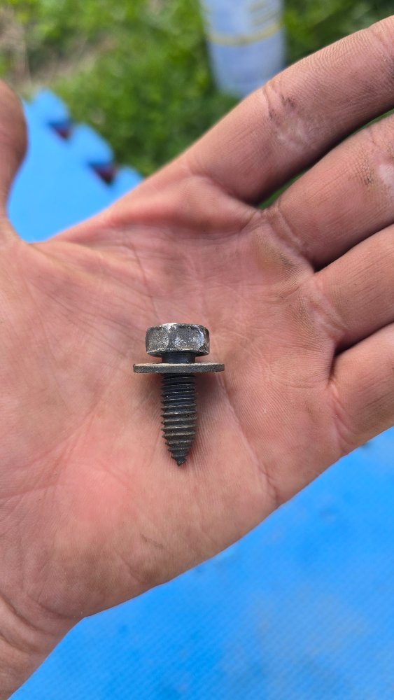

These are the bolts that were used on the seats btw
