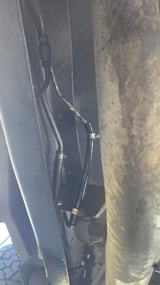

one other thing that just came to me. that cable doesn't look like actual cable that would be used for an amp. most power amp wires are heavily insulated with a thick rubber coating making it harder to cut through into the wire. that looks like regular battery cable which has a thinner coating of insulation. that could be a fire hazard. make sure the fuse is still good and intact where it will blow if the wire shorts out. I always like to us resettable circuit breakers that will trip and have to be manually re-set instead of those glass fuses.
