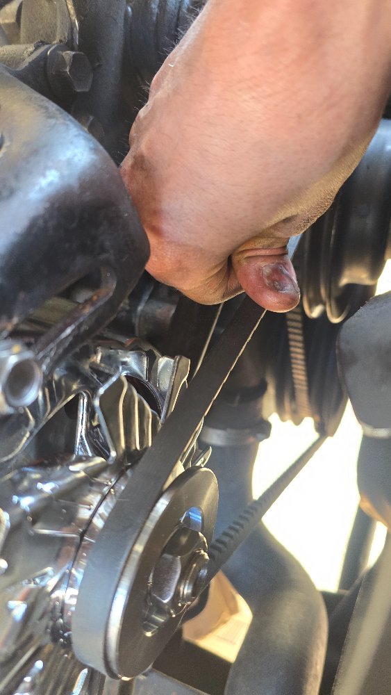

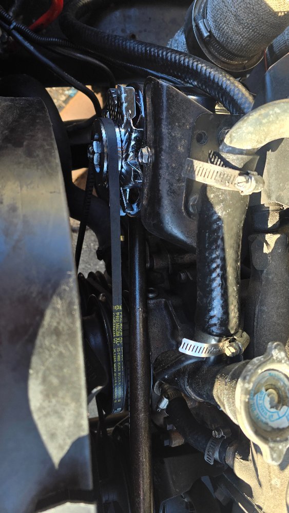

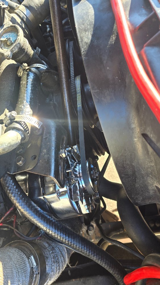

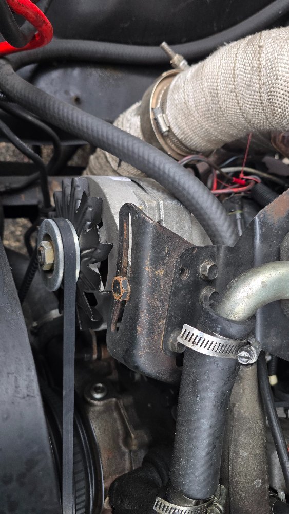

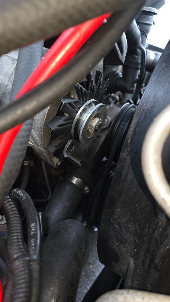

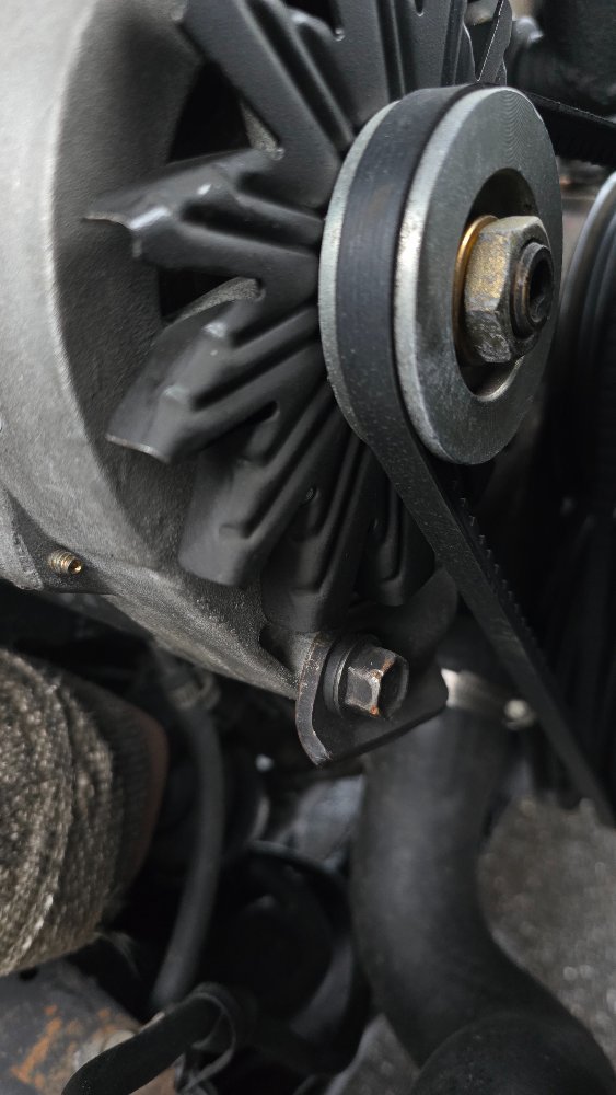

At the very least, the new alternator is more powerful than the old one (100AMPS). Vet discount came in clutch, still, hate how it came to this

On the alternator install- that list of cleaning contacts is critical. Only thing I saw not mentioned is a wire looked close to the wrapped part of your exhaust. Make sure wires are clear of it.
