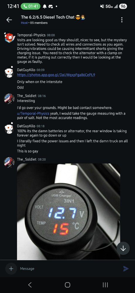

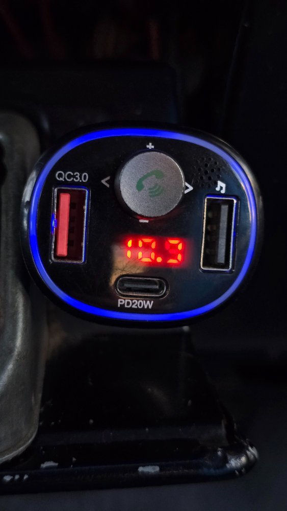

Something definitely isn’t happy.
Did you ever put an actual voltage meter on the batteries while running to compare to the dash gauge?
14.4 is the desired rate when batteries are charging
