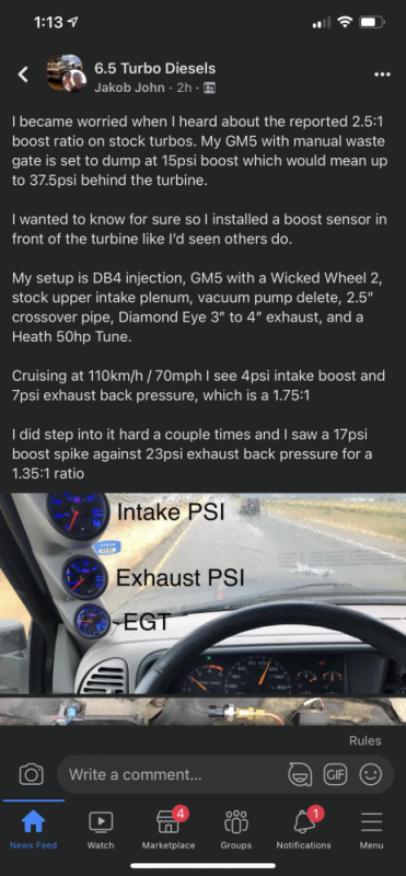

I also got the turbo rebuild kit and installed that when I went in with the WW.First I apologize for reviving this old thread. I just read through the whole thing and really appreciate all the info put into it, found the website linked above and located the compressor wheel. I have been wondering myself on purchasing the WW2 for my truck just for a minor budget improvement and to "hear" my turbo other than from the tail pipe. I am questioning the od of the wheel if it's exactly the same or not for installing on a GM8 that has some small amount of shaft side play. currently I have no issues with the side play, the wheel does not contact the compressor housing. if I were to install a WW2 wheel, would contact with the compressor housing become an issue?
Other things I have been looking at is the GMx turbos and the drive pressure ratio issues and wondering if the 4" exhaust kits alleviate some of this drive pressure or is the restriction within the manifold and turbo connection before the downpipe connection?
