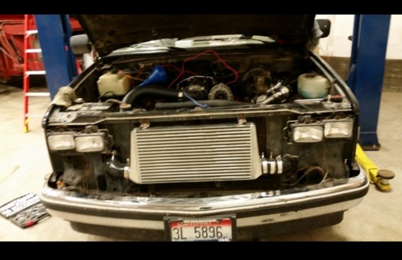

Removed both inner fenders today to get access to the battery tray bolts and get a look at what kind of space I have for a CAI for the turbo. Also getting a feel for what trimming of the core support is needed for a CAC. Seriously considering a universal CAC and mounting in place of the AC condenser similar to this. I'll be taking the grill off now to get at it from the front side and remove the condenser. I was only planning to move the batteries to the bed and build the CAI this round, but might as well jump in head first and go for it.

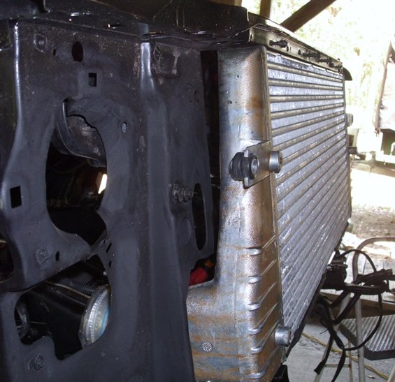

Anyway, a 2nd Gen Cummins CAC will fit flush to the radiator support another words behind the leading edge of the support.

The CAC I'm considering has a core 24"x12"x3", overall width is 31" with tanks attached.

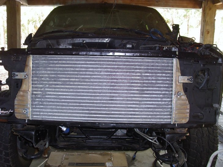

You make it look like it was supposed to be there from the factory! I arranged to pick up a Cummins intercooler from a part out truck today. I will have time after Christmas to get it fitted and figure out piping. Thanks for the look!

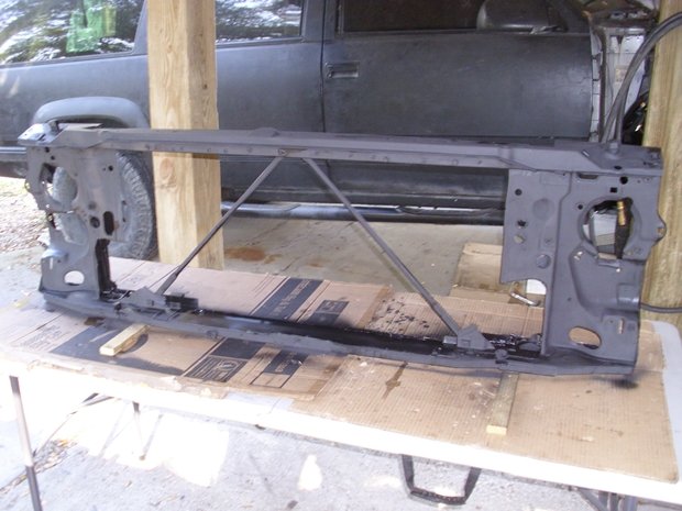

I looked at every angle before I cut the rad support for the 2nd gen CAC and made sure the diagionals would remain in place too.

Picked up the 2nd gen IC today. 40.75" between the inlet and outlet, plenty of room for the stock radiator! Now to get the rest of the front end apart and break out the air saw.
Now when you get to the upright battery brackets you cut the bottom front to clear the CAC in/out & CAC pipe couplers the inner wheel wells will need slight cutting too at the inner fronts later to b covered by sheet metal or mud flap rubber...
