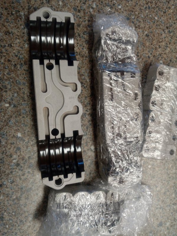

The black coated areas I’m guessing is where the camshafts lay within.
Seems strange that they are at angles, and both ends not the same angle. Or is that an optoptical allusion ? 😹
