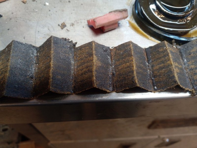

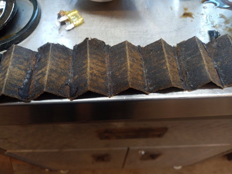

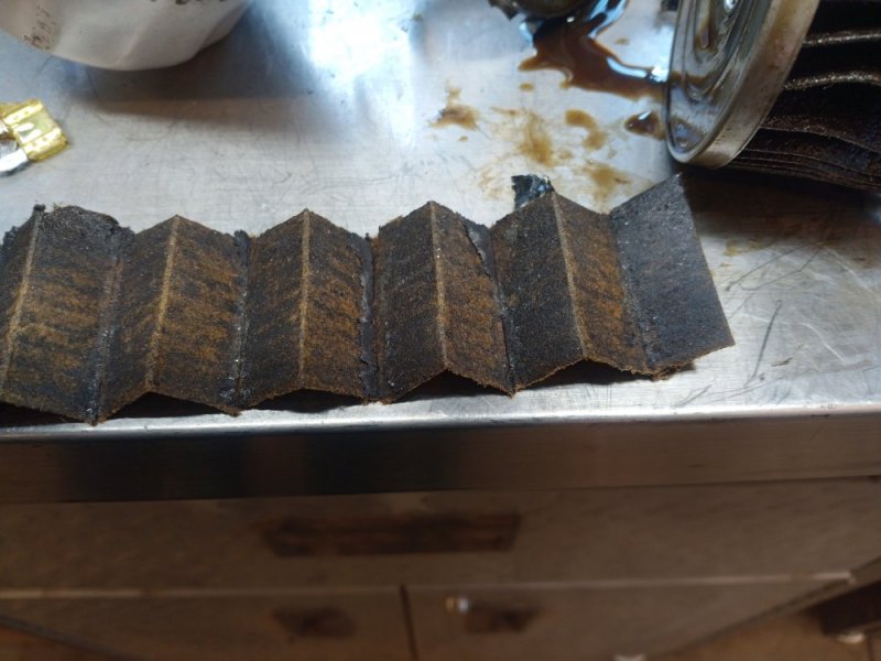

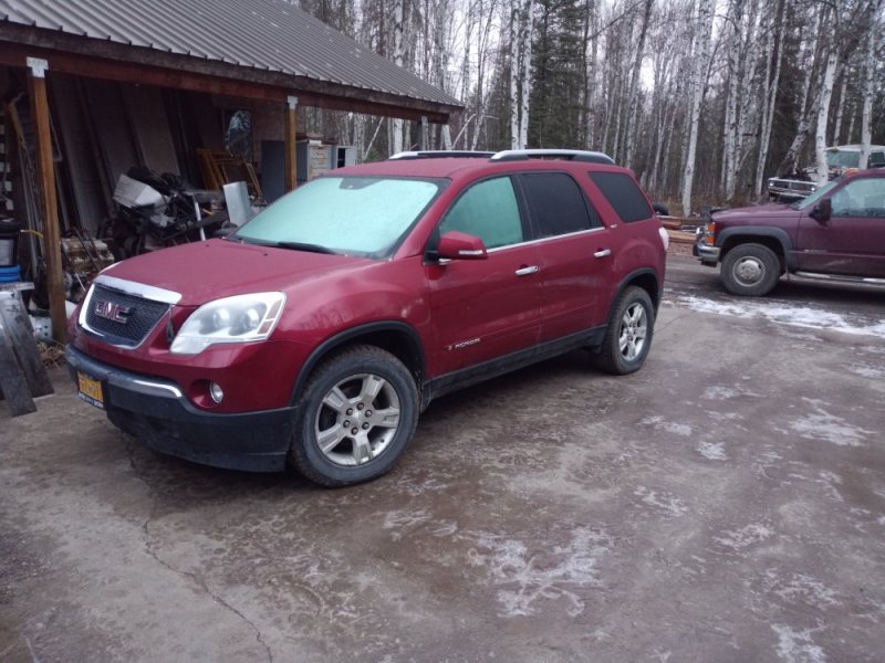

So I picked up an 08 GMC Acadia yesterday. The guy selling it said it had a blown engine but it still ran and drove. So I went and looked at it, body is in decent shape. When it was started it knocked pretty good and then quieted down. When you put the engine under load it would knock but not near as loud as when it first started. To me it doesn't sound quite like a bearing knock. So I did a bunch of research and discovered that it could be the phaser in conjunction with some chain stretch making the noise. So the first thing I'm going to do is pull the oil filter and cut it open and look for debris.
