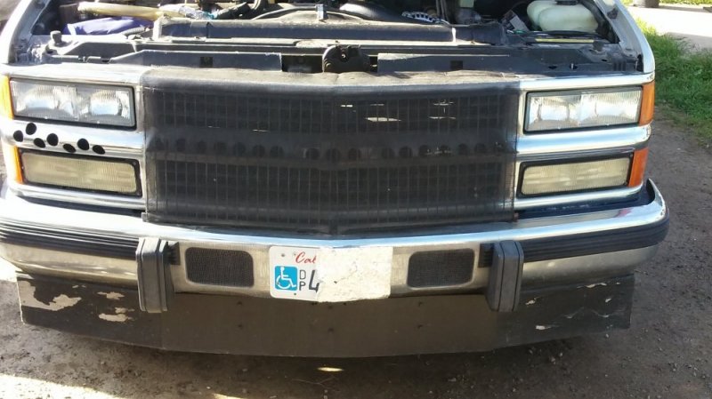

As Shiker said, clean the stack.
That's the coolers stacked in front of each other IN FRONT OF the radiator. Leaves, bugs, animal hair, etc. forms a mat between them blocking air flow. I remove the grille, oil cooler, trans cooler, and A/C condenser. Remove the debris with gloves! I prefer "Wally Mark" fume free oven cleaner to spray and let it soak. Don't use too much water pressure to rinse with, it can deform fins.

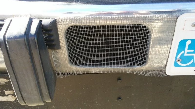

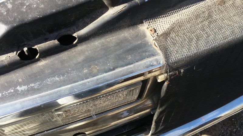

I was amazed at the junk that was hiding there. To prevent a replay of this, after reassembly, I made a protector in front of the grille:
2 re-purposed oven racks attached at the top of the grille and the top of the bumper, covered in front by 1/4" (more or less) hardware screen. Final (or first) layer of protection is cheap window screen as a disposable and easy to replace way of stopping the crud. I get a few odd looks, but I don't care.. It works. I need to repaint the air dam. You may also notice the added cool air inlets below the PS headlight.20170221_151622.jpg 20170221_151738.jpg 20170221_151753.jpg
