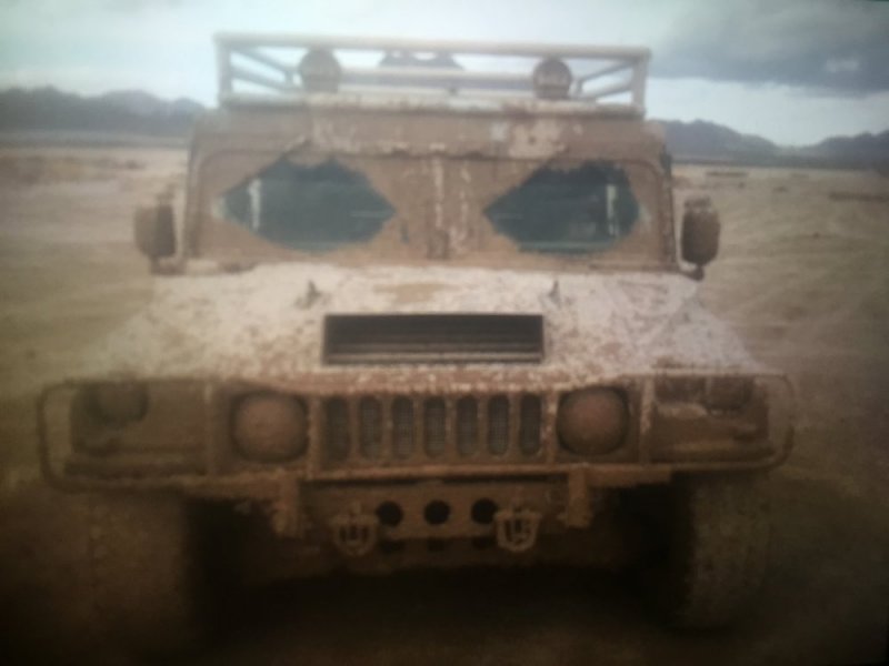

Welcome.... we are close enough for a meet up some time, I'm just outside of Spartanburg... I have a "one off" fan system on mine, part Humvee part custom made....
