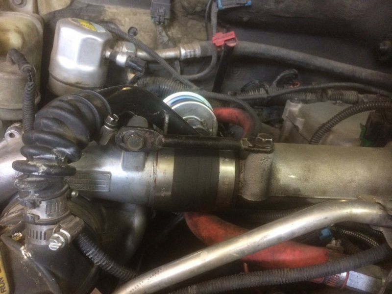

Check the boot from turbo to intake for leaks. It capping off suggests you’ve got a leak.
The boot appears to be in good shape. Ha it off a couple of months ago and it did not appear to be breaking down on the inside.
Might pull it off and take another gander at it. LOL
Boot is okay. While I had the upper intake off I unclipped the connectors under there and scrubbed the terminals real good.
