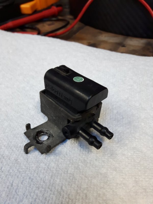

I put in a new solenoid and went for a spin. Still no boost.....
I checked the plug to the solenoid and it has 13 + volts to it at Idle ( this should mean solenoid open and vacuum supplied to the wastegate diagram = wastegate closed and turbo active)
The solenoid checks out on the bench with 12v supplied to it. Back on the engine it leaks vacuum and is vibrating like the solenoid is being fired and released a few hundred times a minute.
What exactly should the operation of the solenoid be? Do I have the wrong one?

Yes, that is the correct solenoid. The solenoid will bleed varying amounts of vacuum to the atmosphere until vacuum is needed.
If full vacuum is supplied to the waste gate actuator, it will be under full boost constantly.
The ECM pulses the solenoid to give the enjun the proper boost at the various load levels.
With the vacuum hoses disconnected, hook a vacuum gauge to the orange tube coming from the vacuum pump.
Depending on Your elevation will depend on how much vacuum is being pulled.
Here at 2,200 feet above sea level, the new vacuum pump was pulling over 20" of vacuum.
Next step is to hook a vacuum pump to the waste gate actuator to be sure that the diaphram is not leaking and that it will hold vacuum, it should not leak off with vacuum applied.
Report back Your findings and We`ll go from there.

Like minded! I did that last thing. Nice 2psi at cruise. Pegged 10psi under full throttle when I backed off.
Could be then that the solenoid is not doing its job.
On Mine, only time I was getting any boost at all was when pulling a hill, it then would go to not over 3 pounds of boost. I cleaned the terminals that plugs into the solenoid and then could get almost two pounds of boos cruising on the flats. Still not over 3 pounds on the steepest hills, until I changed the vac pump.
My truck has had the vac pump deleted snd a manual wastegate added. Im working backwards putting the vac upwrated waste gate back on - and in full disclosure.....sorry...Im using an electric vacumme pump. Its only achieving 14hg of vac and it builds slowly. Im guessing its just not up to task.

Just jury rigged a 12v compressor with the intake side supplying vacumme to the wastegate system. Its a piston pump that makes high 20's hg.
Success! Turbo whistles. 1-3 psi at cruise and 10 at full throttle !
Thanks everyone. I'd still be messing with solenoids without your help.
Now - any suggestions on a descent electric vacumme pump. Mine was a little ford/dodge style one. Clearly not good eñough.
