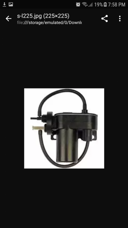

This pump might control HVAC but is a loser for the ecm controlled wastegate (unless mine is dying and someone has had better luck with one) Screenshot_20171026-195832.png 6

I replaced the electric vacuum pump on My BILz 2000 VW Passat, it was electric and looked to be high quality and pretty hefty too. i dont know what the price was but I bet it was pretty hefty too. LOL
The new Dorman pump was $136.00

Your better pump may be overcoming a leak esp. in the WG can itself. The diaphragms do get holes in them from age/wear.
I did check the waste gate actuator with the vacuum pump, it held vacuum indefinitely, well, for about ten minits anyhow. LOL
