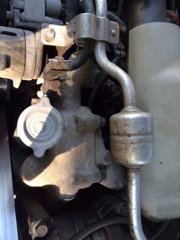

i believe i have one on my 96. it's a single stat. i can take a pic if interested.
That would be awesome thank you! Most of the crossovers I have seen, have a raised part number on them somewhere. Not sure if they are in a camera accessible location or not however...

here's what i got:
Thank you deejaa!!
Exactly what I was looking for! and that verifies the part number too.
Hard to tell how much room I would actually gain for the throttle bracket. Seems to me the upper hose outlet would be the limiting factor on both the single and dual housings. I'm still going to try and source one for the project anyways, and use whichever one works the best.

@HighSierra86 would pics of my "rare 96" crossover help?
