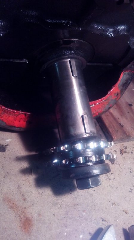

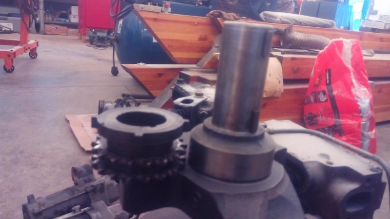

The front of the 6.5 crankshaft has a reluctor on it for the Crank Position Sensor, the 6.2 doesn't, which I was aware of. I was under the impression that swapping the reluctor over to the 6.2 crank would be easy. I haven't pulled the reluctor off the 6.5 crank yet, but the reluctor appears to be keyed onto the 6.5 crank. The 6.2 crank doesn't have a keyway cut into it beyond what is needed for the timing gear.
Once I pull the reluctor off the 6.5 crank what can I do to key the reluctor to the 6.2 crank. without pulling the crank and having a keyway cut? Unless there is a way to do this without pulling the crank I'm stuck. If that's the only way to continue with the swap I will just have to repair the lifter problem and put the pickup back together with the blow-by and oil useage.

Well, ak diesel driver was able to give me the correct configuration for the reluctor/timing chain sprocket as being all one piece. That takes a big load off my mind. Thank you!
reluctor is part of the crank gear. have you tried swapping yet?
Your 6.5 should look like this
Your 6.2 should look like this
Even if you only have one key it should work
