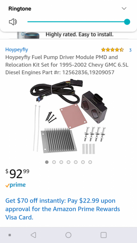

So my first post was my intro and I said about Beast and her black smoke/runaway throttle issue. Changed out the PMD (my sis bought me 1 off Amazon that came with a heat sink and relocator line) added a #9 little green piece (
) and she is a bit better. Doesn't immediately run away but now takes a second to hit 4,000rpm's instead of buried. Is it a bad PMD or is it the IP? Hopefully getting a scanner on it this weekend. No check engine light unless we pushed it hard when it would still go. She hasn't stalled out except in Jan when we had a cold spell and she wouldn't stay started one day until it warmed up (started plugging it in when at home) but that may have been gelled fuel.
Now it has had problems in the last few months (since Nov/Dec) with gas pedal issues (sorry not a mechanic. I just pretend I'm one). Above 50mph the throttle is either on full as soon as I hit the gas (is it still a gas pedal on a diesel?) or when I let off it starts "dying". No sweet spot. And black exhaust. And reving at 2,000ish until warmed up and dropped into gear.
Wondering if maybe its worth it to get a pmd from AutoZone with at least a 3 month warranty and try that. Or just jump to letting it sit til I can get an Ip.. Finances suck in my house. Or is it maybe air filter? Can one needing changed (also black) cause some of this? Could it still be the pmd? And we just got a bad one? It's now mounted inside the front bumper behind the licence plate. Texas (70 miles east of Dallas) requires front plates.
