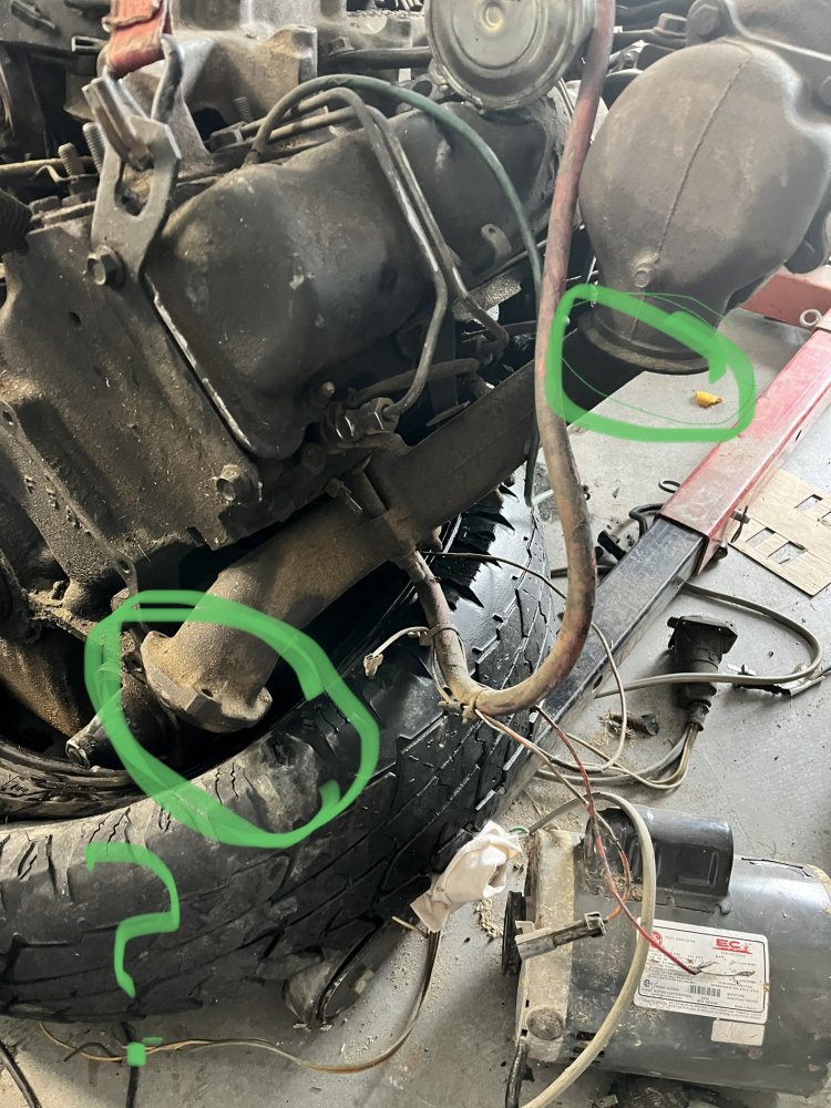

One thing I wanted to ask you guys though, I got looking at the donor engine, and wondering why there is exhaust coming off the manifold and out of the turbo both?
I’ll attach a picture. Can someone load a picture of how the factory setup looks?

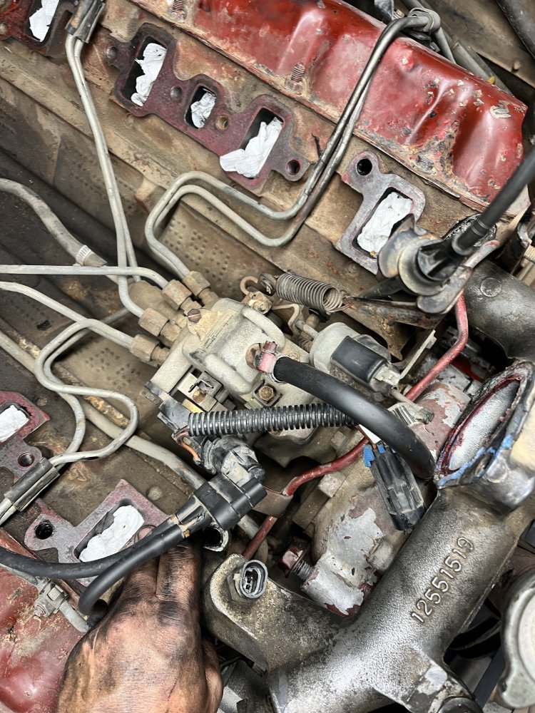

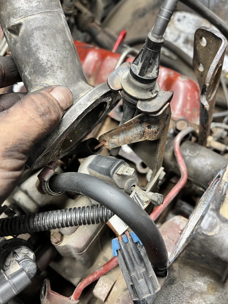

So, besides the air filter setup, I’m puzzling through another problem. If you guys know of a thread where this was addressed. That would be cool. Didn’t find anything right off, but I’ll keep looking. I decided to try and make the serpentine belt setup fit on my truck. The t-stat housing needs to go right through where the throttle cable bracket lives. I’m about to call it a day and go search the interwebs for solutions. Here’s a couple pics illustrating the issue. CA01D058-A856-46F7-BCBC-57B21B847A4A.jpeg4FA15A6C-AEC6-4640-849B-444DE50E79F2.jpeg

@Jake907 the best tstat crossover housing that doesn't interfere with the mechanical pump bracket is the 92-95 housing, faces forwards. What year/ style is the thermostat housing currently on the truck? Looks like the rare half model year '96 style but can't really tell from the pictures and I don't know what came stock on the '89 in your sig.
Only other option is to modify the existing bracket to clear the water neck or fab your own
I was told the donor was from a ‘94. And it definitely faced rearward, my ‘89 faced forwards. The difference is AC placement and also the ‘94 didn’t have mechanical linkage to navigate around. I’ll probably have to do as @MrMarty51 suggests and fab my own. Just putting feelers out to see if there was a kit or a stupid simple idea I was missing. Thanks
the one in your 89 should bolt right up. post some pics of the two engines and stat crossovers. grab the block numbers from the 94 engine where the bellhousing bolts up on the drivers side top. those numbers will tell you what year and revision engine that is.

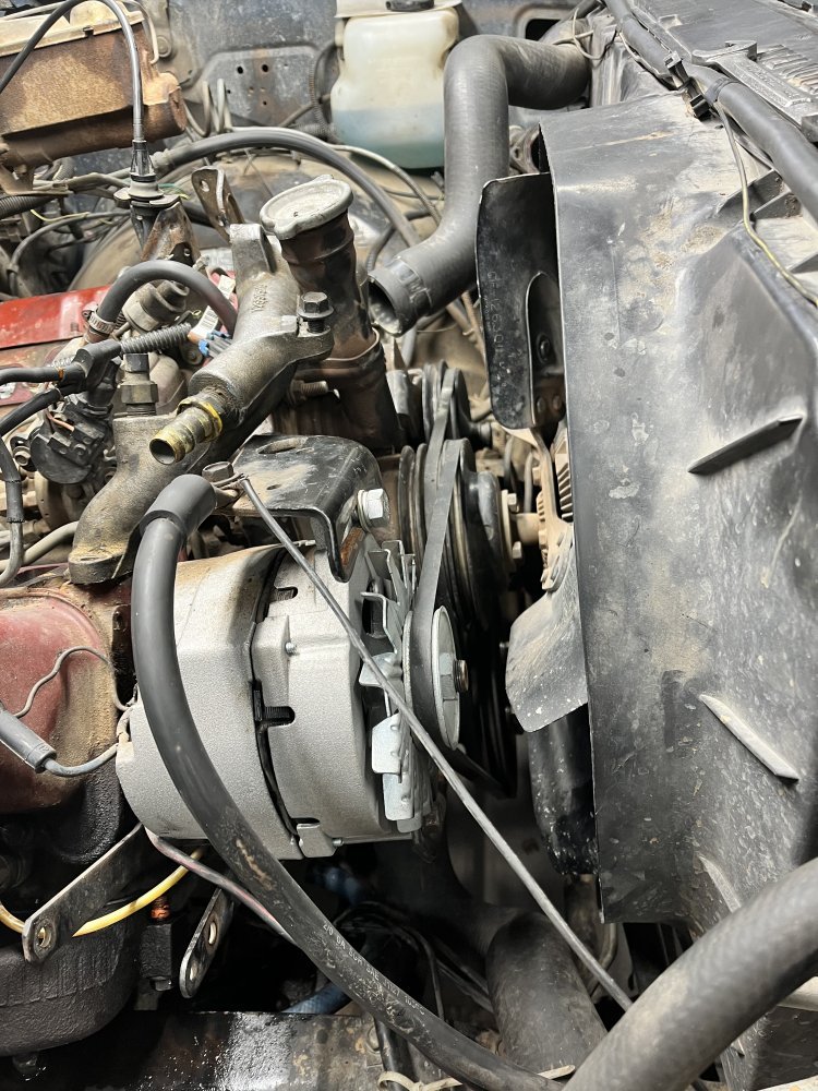

The tube from my 89 will definitely bolt on just fine, IF I don’t do the serpentine upgrade. I really want the bigger fan, bigger water pump, and AC brackets that I can get if I use the serp belt setup from the 94
iirc I have heard others say that the v-belt setup is a much desired setup to keep. one belt snaps and you can still keep her rolling for a bit. single serp belt snaps and your down till it's replaced!
Advantages of v belt is the waterpump never got messed up with unbalanced flow. Also the hmmwv fanclutch system just bolts on without issues. Different fan iirc but those are easily found with tons of hmmwv parts around for years to come. Then get a rebuild kit for the fan clutch down the road - basically seals and tiny brake shoes. Then the 12v solenoid and a couple custom power steering hoses. Still use any electric fan controller you want to adjust fan engagement where you want it. Add a switch for force on and trinary switch for fan engagement with a/c high pressure like modern rigs.
