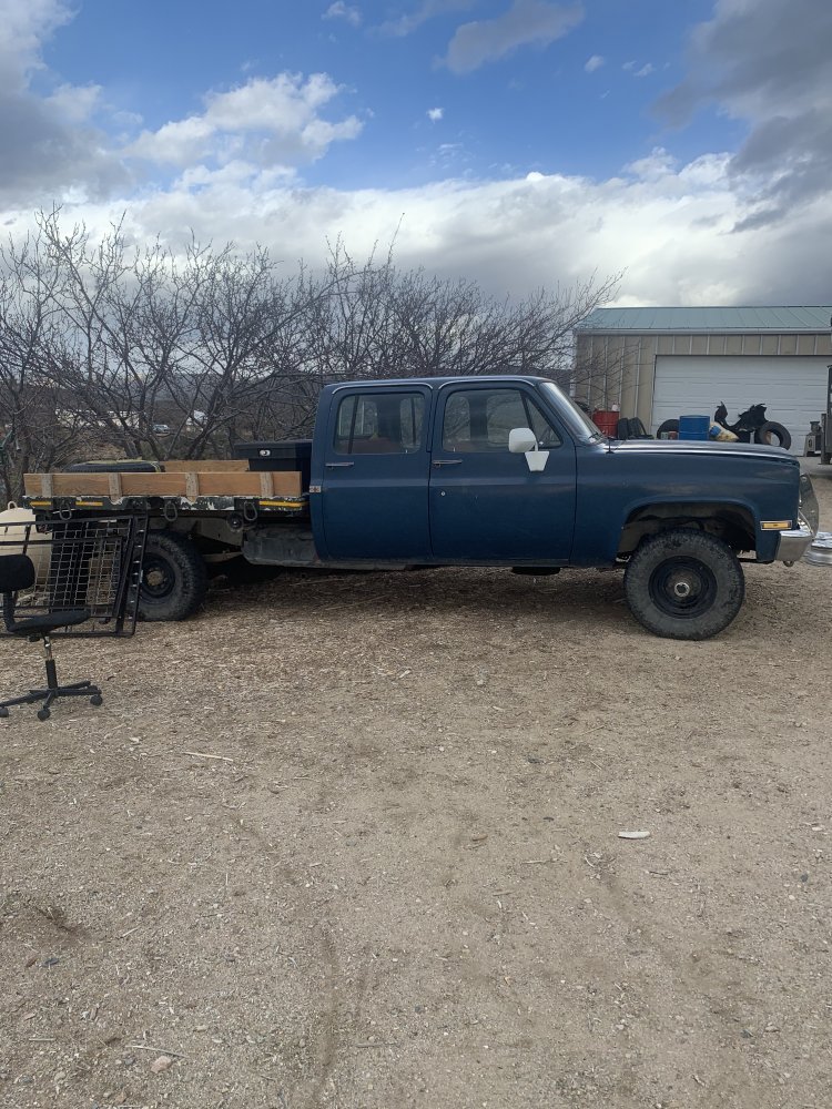

Hi folks, I’m looking for a few good gurus to help me with my project. I have an ‘89 GM diesel crew cab. She spent many years as a fleet vehicle for a pipeline service company, then went through half a dozen private owners before I rescued her.
I was told she had an 6.2L originally, and that later there was a crack in the block and they ordered a new block, and that at that time GM had discontinued the 6.2 and instead sent them a 6.5 block and were told that everything would bolt on and run just fine. So if all that is true then I have a 6.5L N/A all mechanical engine.
So the other day a guy at work sold me a mostly complete 6.5L from a mid 90’s truck, so that I could use it as a donor. I want to turbo charge my engine, and move over the serpentine setup.
