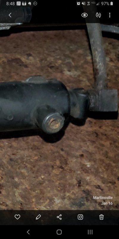

OH MY, if there is not a bleeder device on the top side then, I believe that slave cylinder is about done in. Unless You can drill and easy out the screw, without messing up the seat.
I also think that the bleeder should be on the top, but, not sure if it really matters. Air bubbles usually tries to float upwards.

If that one isn't leaking I would still use it, if you follow my directions you can still bled it just fine, you just need to be quick removing it and reinstalling it.. but yes their should be a bled screw on the top..
