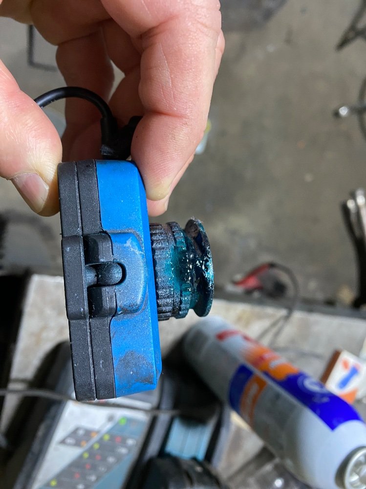

I got the replacement front doors painted this weekend. Initially the plan was to just do the bottom color change from silver to sandalwood and then just spiff up the emerald green….. but after seeing how well the bodywork and paint on the bottom of the doors turned out yesterday, I decided it would be a disservice to not also do the same to the top part of the doors - there were some dents and deep scratches that would have still been there with my initial plan, plus I wasn’t sure how well I could have cleaned up the fading at the top, so doing a fully bodywork and respray situation seemed like the best path to an outcome I’d be happy with. They turned out pretty well, though if the damn paint gun hadn’t started shooting blobs of paint sporadically, they would have turned out quite well, so that’s disappointing. Even so, they will be a nice improvement to the truck as a whole and one step closer to removing the rust from it.
All night I was thinking about the blobs of paint I experienced yesterday. I started to wonder if I had the light on my spray gun a little far forward so then it was collecting paint from the edge of the fan pattern and then once enough collected it would drip off into the spray. I went out and looked at the light this morning. SURE ENOUGH. I wish I had noticed that while spraying because I could have corrected it and not put defects into an otherwise good paint job. I guess another lesson learned. IMG_3918.jpeg
