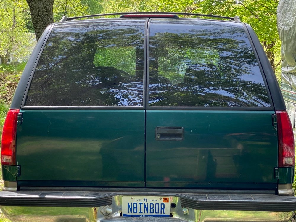

Yesterday I got the cargo doors swapped out on this thing. I bought pins and bushings from Cunningham Machine. Really good stuff. I also bought their pin removal tool - that works great on the lower pins, but is useless on the upper pins. I thought about making my own tool for the uppers, but didn’t feel like investing the time, so I used the grinder, then hammer/punch technique. Pain in the ass, but it’s done. So nice for the unsightly rusty doors to be gone. Not sure if I want to reinstall the Tahoe badge or not. Still thinking on that.
