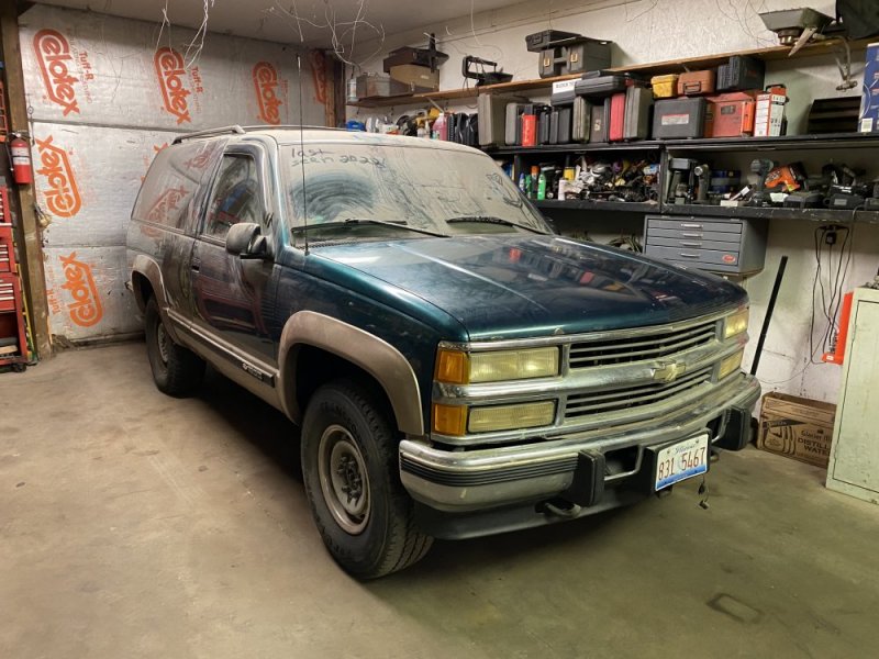

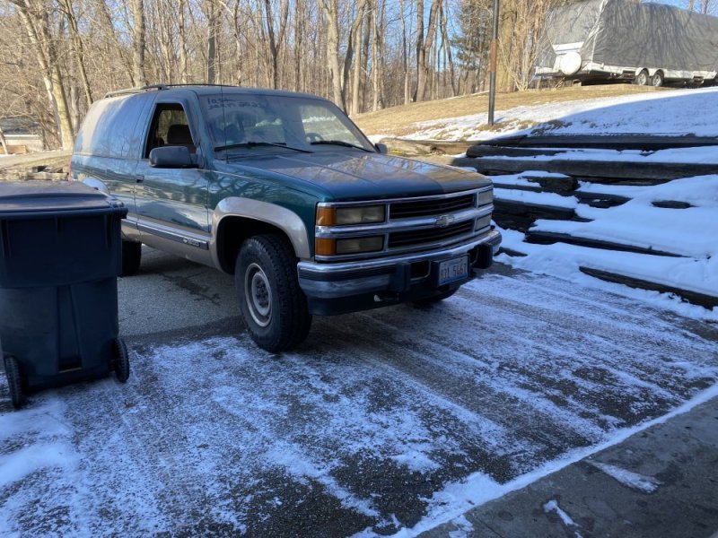

I was intrigued, but I didn’t need it. Hmmm…well I do need a Fluidamper for the next build….then for another $300 I get a whole truck. Oh and I already have a 92, 93, 94, 96 and 97…. looks like I’m missing a 95…..guess I better contact him. So I started a conversation with him to find out more and let him know I’m interested. The more I learn about him and the truck, the more I’m interested, but what do I do with another truck? I knew it could be a runner with just a little work….ok, I can get it running and then let my dad drive it for funsies. The more I thought about it though, the more I wanted to drive it. Well it has been a drag driving the dually anytime I’m working on the Envoy, so this could be handy as a spare vehicle. Ok, I’m gonna get it. It took a few weeks for schedules and weather to work out, but I finally made the 6 hour round trip to get it last weekend. Here’s the first pic of it in the barn.

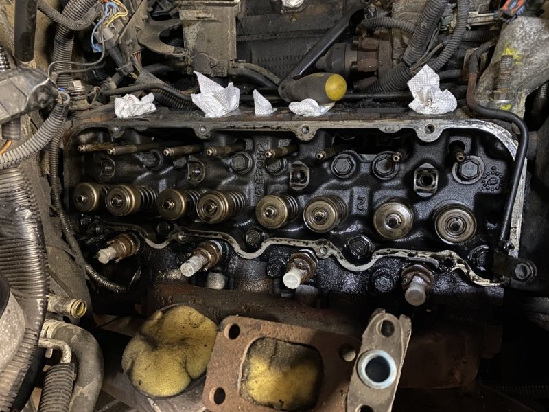

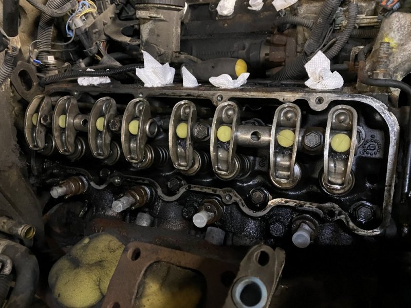

I wanted to finish the maintenance that he started so I removed the intake, valve covers, injectors and rockers. I popped the injectors and they tested OK so I reinstalled them. Then I swapped a low mile set of rockers I had.

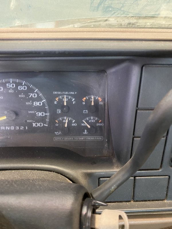

I resealed the valve covers with The Right Stuff. Then on to installing a non-EGR intake. The turbo that came with the truck was a little tight, but I had a nice GM8 on the shelf so I installed that instead. Then it was just connecting the dots for the electrical connectors and what-not. The tensioner pulley was tight so I put a tensioner on that I got from @WarWagon. Finally yesterday it was ready to start. I put a couple batteries I had laying around in it and gave it a try. It cranked pretty slow. I hooked up the battery charger on start mode. Still slow. Battery charger and jumper cables. Still slow. I suspected the starter, but the maintenance notes said it was a newer rebuild. I decided to buy a new pair of batteries since these were questionable. It cranked better and longer, but finally the starter began to smoke (and yes, I was taking breaks cranking it over). I just happened to have a new reman starter on the shelf, also from @WarWagon so swapped that out. Now it was cranking good. It took a long time to purge the air, but finally it started. It runs good and carries good oil pressure!
I’m VERY pleased with this purchase. I told Kelli I’d have it driving in 2 weeks, I was very happy to be able to do it in 1 week instead. And look guys, I CAN bring home a non-running truck and get it running without tearing it down to the frame first! It’s also been fun patching one together from the stash I’ve accumulated here.

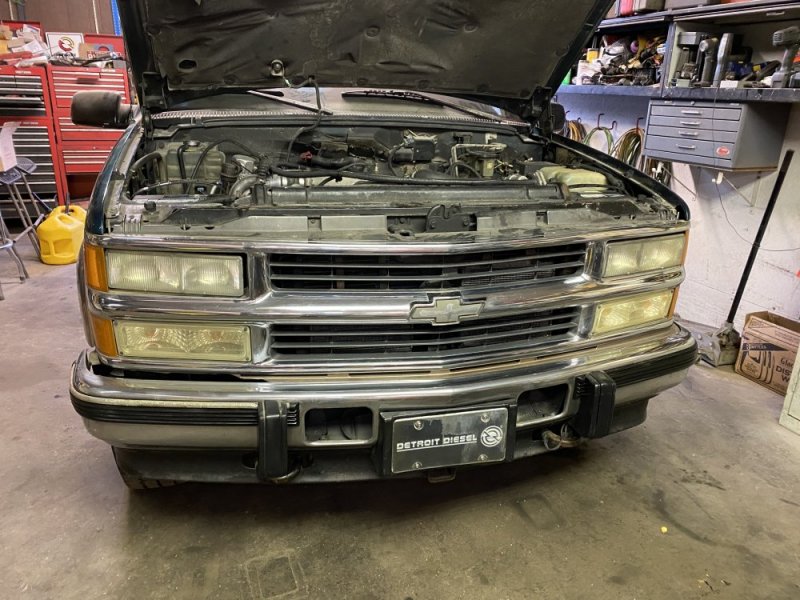

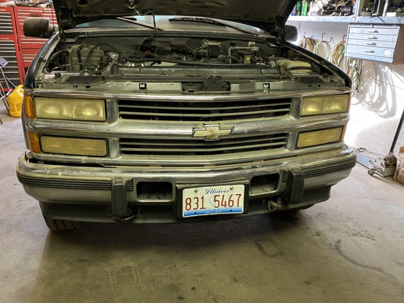

Tonight I swapped the lights and grill for ones I had here that are a little nicer, they are a little yellowed so I will polish them soon.
All the lights and the horn work, nothing major that isn’t working that I’ve found so far. Tomorrow night I’ll begin proactively replacing the front brake hard lines as well as all the brake hoses (the truck came with new brake hoses in the boxes even).

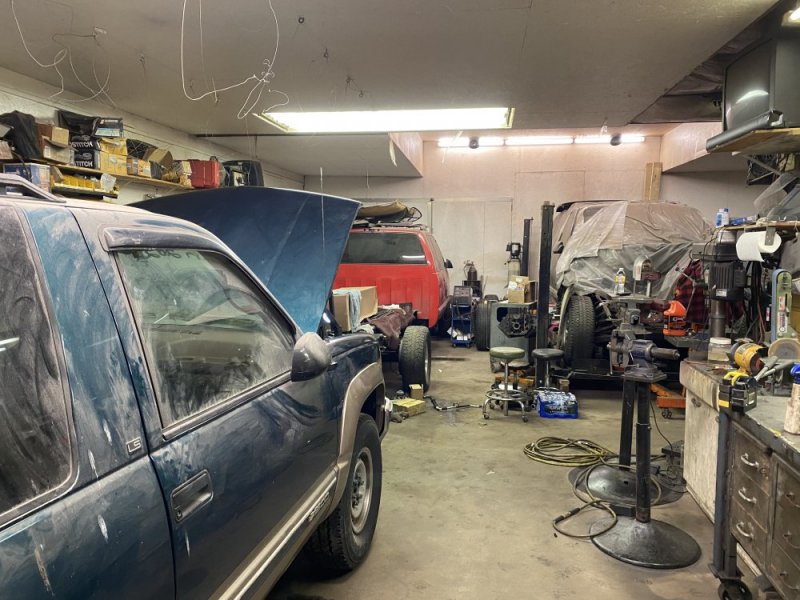

Happy and sad to see it running. A little sad that I didn't get it done. But happy it's out of the way and hopefully I can get the 94 in soon and sort the no revolving of the engine situation out.

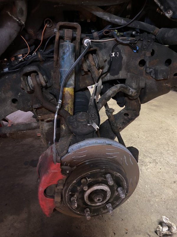

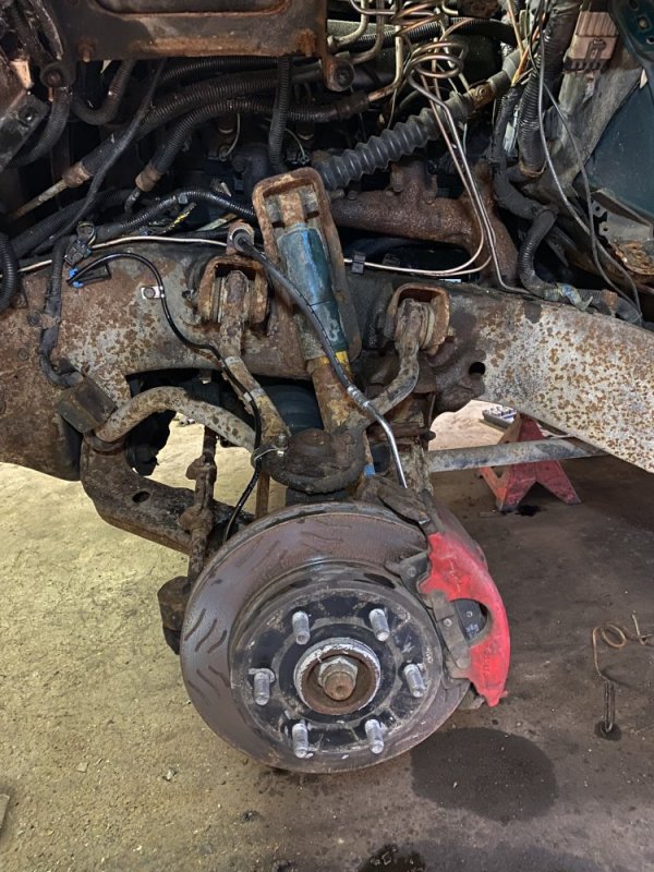

Spent the last couple nights doing front brakes. The pads were worn out so I decided to swap the Powerstop brakes from the black Tahoe onto this one - they only had a couple thousand miles on them and the black one is going to get a GMT800 spindle swap anyway, so it was nice to have a use for them. I did the front brake lines in nickel-copper….if you haven’t used this stuff, I definitely recommend you try it - it isn’t that much more expensive and it’s SO easy to work with, you can make pretty much any bend you want with your bare hands and bend it multiple times without kinking. I won’t use another brake line again if I don’t have to.

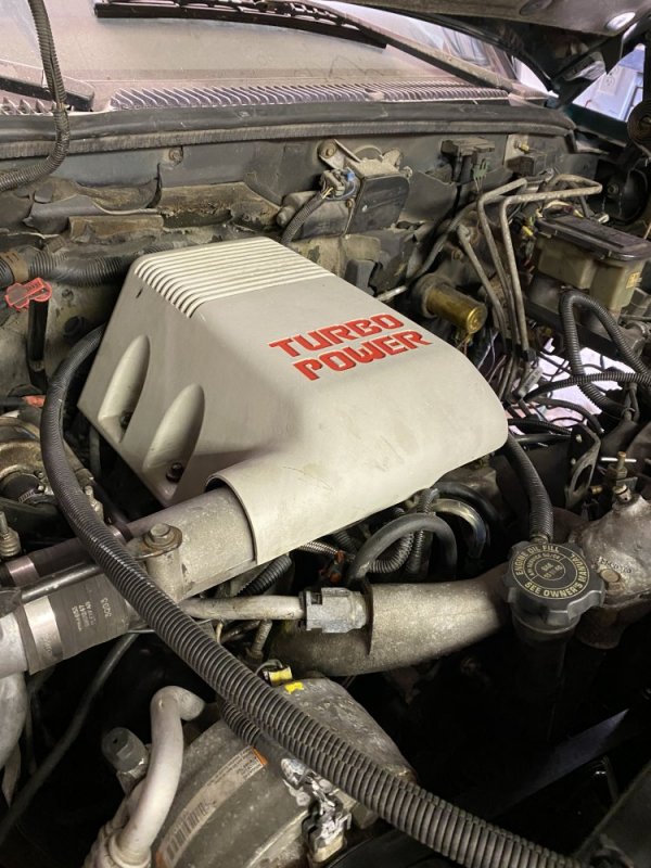

I also found a factory engine cover while at the local yard so I cleaned that up and slapped it on for funsies since the intake is all stock still.
View attachment 73070View attachment 73071
I sold all the covers that came my way. I never saw a practical purpose for them. LOL
I’ve never had one before so I thought I’d try it out for a change. Definitely not practical, just uniquely 6.5.
I’d like to have one, even if it just hung on the wall. I just like things to be complete.
I dont know if one would fit with the turbo I now have on the engine, if not, as stated, a mighty nice wall hanger.
