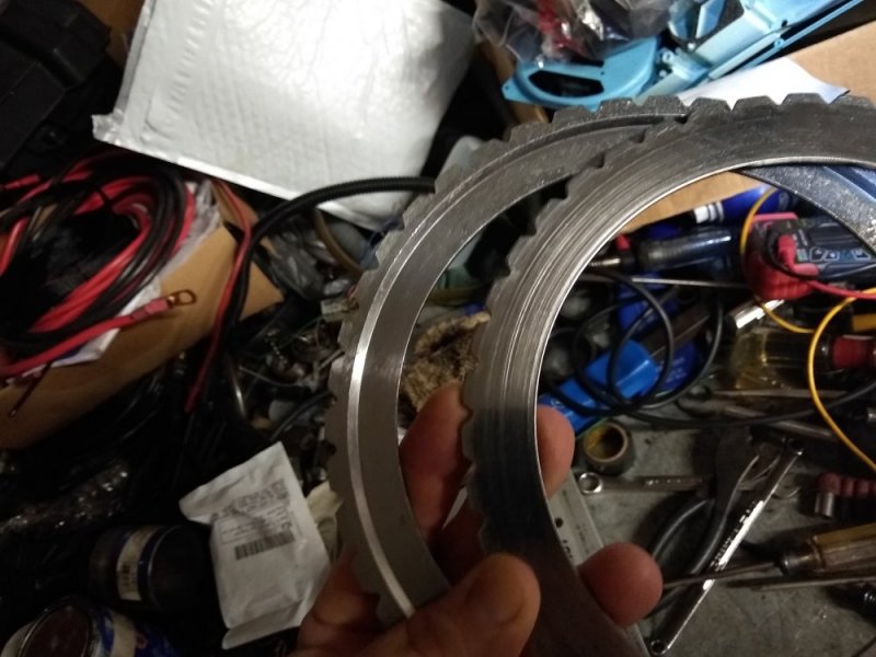

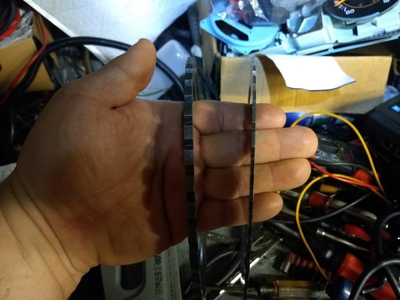

The C2 alto apply plate is because it's almost twice the thickness of stock and doesn't come with the raybestos pack. The raybestos pack uses a stock C2 steel plate as an apply which leaves you with apply pressure only on the outer edge of the clutches in a 5 speed leading to failure just like stock did. To run the alto plate you have to also switch out to thin instead of thick steels.

I don't have an alto 5 speed C2 apply plate, but this 6 speed plate should give you an idea of how it helps. On a 5 speed apply plate the thicker portion comes further in since the apply piston on a 5 speed only touches the inner edge, a 6 speed has centered apply. The stock C2 steel is .087 thick and is also used as the apply plate. The alto is .105 thick at the thin point, cllose to .200 thick at the thick portion, and is a harder material. 5 speeds had problems where only the inner half of the clutch would be worn due to the offset apply. The thicker plate helps to apply the whole clutch face.

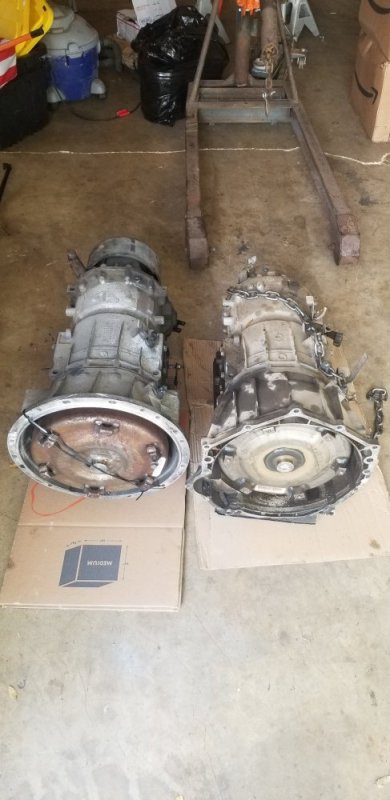

Not to hijack, but I am in a very similar situation. I have an allison 1000 5 speed 4x4 trans & an allison 2000 (with park pawl) 6 speed 2wd.
I just want a 6 speed 4x4 ally. Will I be able to just hijack the output shaft & tailshaft of the 4x4 trans? Not sure if it will work or not due to it being a 5 speed.

It's possible.

The September 2009 issue of Gears magazine shows how to repair a broke tailhousing without removing the transmission. I think the same procedure could be used to convert the 2000 to a 1000, and as Rockabilly said, the planetary also needs to be changed. The hole for the output shaft, through the p3 planet, is larger for the 34 spline shaft on the 2000 model.
