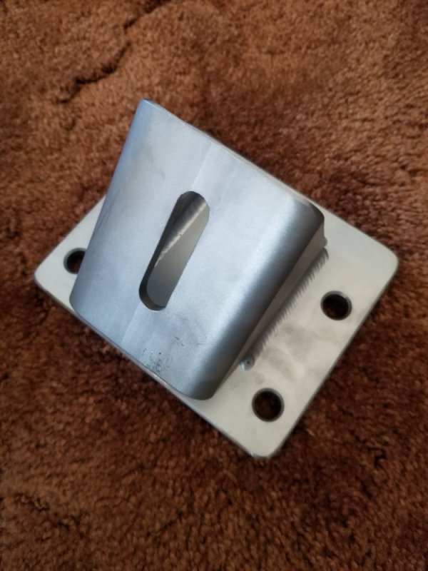

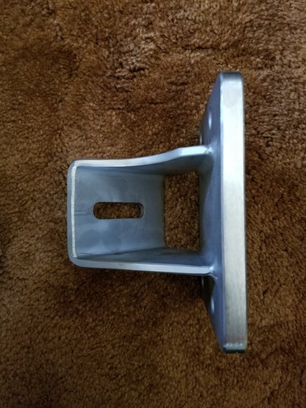

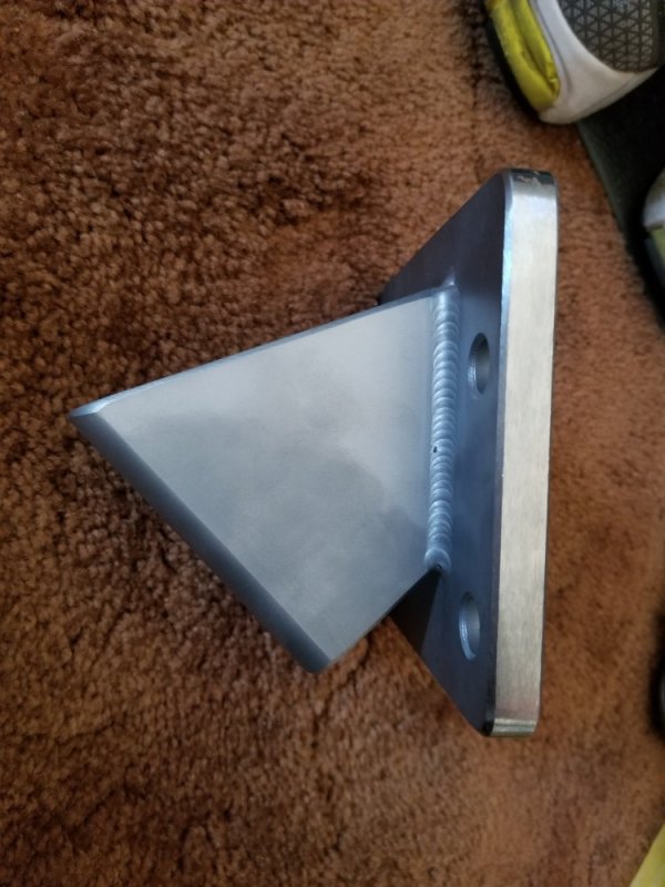

Ok, so I solved one problem. Flex plate had no issues. I then received the motor mounts a few weeks later. This is where I guess the cost factor plays a role.

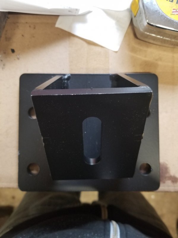

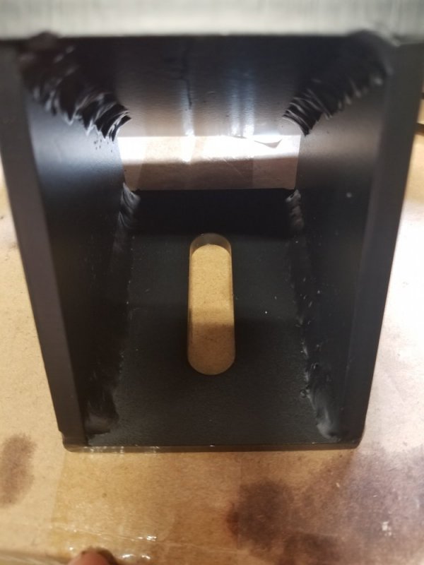

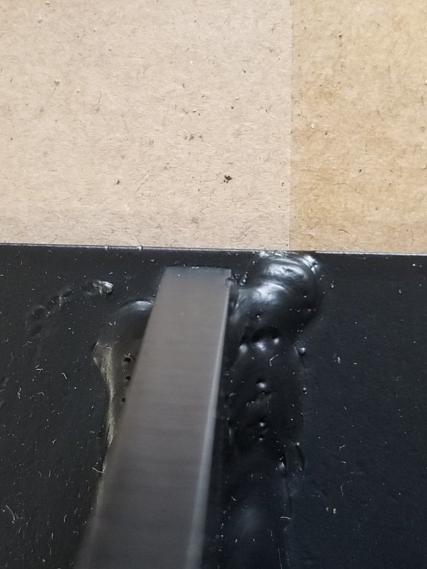

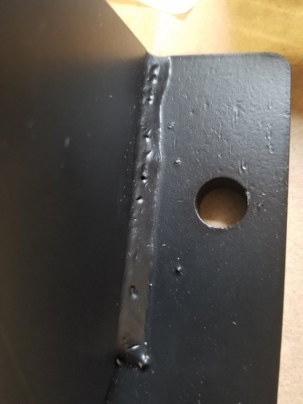

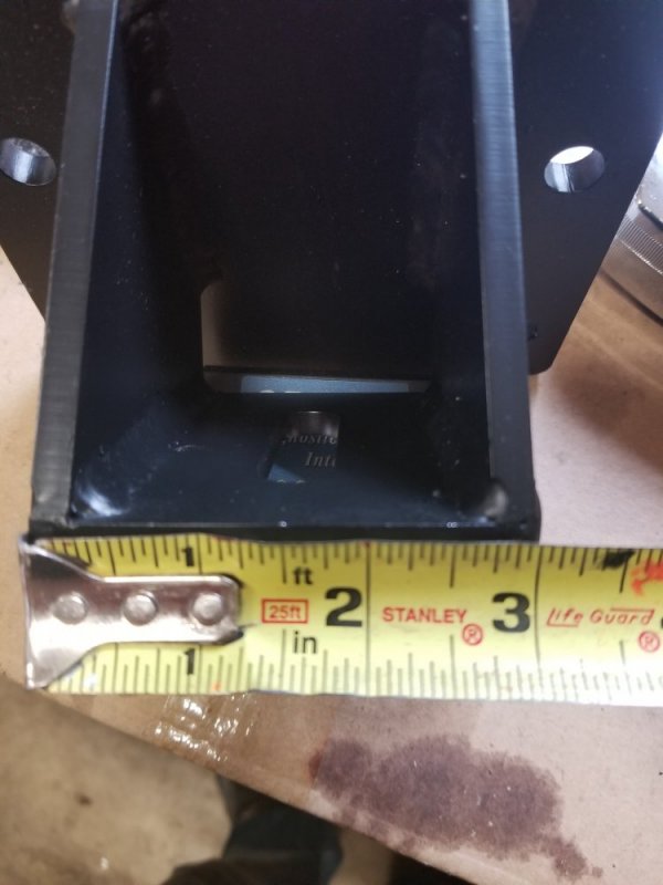

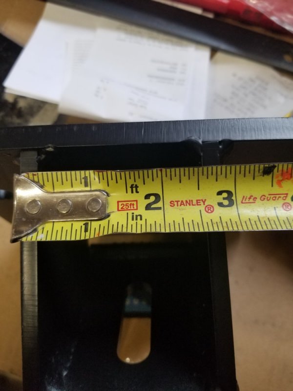

These are the mounts I received from adventurevehiclesnw.com. I am not impressed at all. I am not a professional welder, so I cannot say accurately whether these are good or not. However, for the professional welders here, I would really like to get some advice as I'm now really in a pickle. I have emailed Joel to see if this can be resolved, so we will see what happens. This mount is on the passenger side & as you can see in the first pic, its tilted & appears to not be welded correctly in line. You can see how the legs are not flush with the top like it appears they attempted to do.
I'm not meaning to bag on either company, as no one is perfect. I am merely sharing my experience with both as I'm sure some are contemplating going thru either company. I would however like to get feedback & possibly some ideas as to what to do now.

Email Them and show them the difference. Ask for another set properly made this time. Tell them to include a shipping label to get the old ones back after you get the new ones.
I can try, but I just dont think that's going to work. I feel like that's going to be hard to argue considering this is "custom". I've never been in this situation before.
If not, then it’s a case of run it how it is, or hire a local welder to modify it.
Yes the first one looked picture perfect. And the second one is not straight. The welds dont look great, but I dont see proper penetration. In person inspection might say its ok, I am only seeing it on my phone.

I'm going to see if I can find a welder to take a look at it & see what they say. If they say it's not good, I'm going to approach AdventureVehiclesNW & tell them that a professional welder deemed it unsafe or something & go from there.

Retake the pictures you took, specifically the last 3. Get them in good lighting and post them up we can mark up the pics for you to email them. They wont fight you on it. Partnof the welds are good and it will be plain to them they need to redo it. Your pics showing they are not even square should be included.
Just dont be a jerk in the email, but explain you know sometimes things slip through quality control and you would
Like to have them redo it rather than just having them retuened for money. There are several welders here.
I have to try marking them up on my phone wih my finger, if someone else here can do it a little more professionally, plz jump in.

MOVING ON. I'm really bummed here. I emailed Joel & he said that he has them in a jig that holds everything in place while he welds it. Ok, looks like something slipped but whatever. Secondly, that doesn't change the weld quality. Which is what I'm really worried about. This is going to hold the motor for Christ sake. Last thing I wanna do is have those break & the engine drops while going down the highway. Who knows what would happen then.

Buy the appropriate steel in the proper thickness, then cut out new pieces and have them welded together, using the mounts You have as a guide, then return them boooogerd mounts back to them, explaining they are unacceptable and You got the issue resolved.
