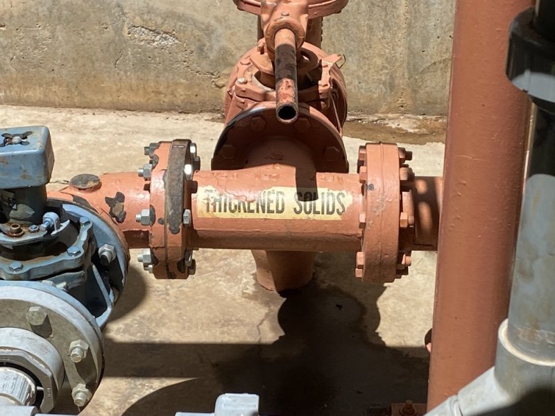

Being skeptical is a good thing. But if you had seen 6 on rigs and saw 2 of them fail in just a couple years I would get saying not worth it. But GM reprogrammed some to help reduce the problem, right? Would a person reprogramming be wrong? Thats all this is - an inline reprogram. I am restricted from talking about my current job online. I dont think a pic showing a label on a pipe is incorrect to do. But use imagination and figure if I may e know something about pulse starting on compressors and pumps.
