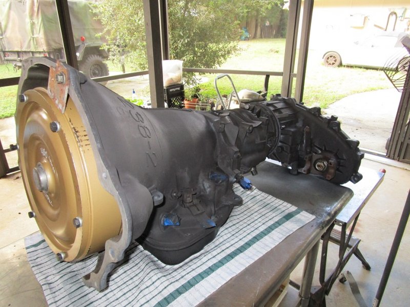

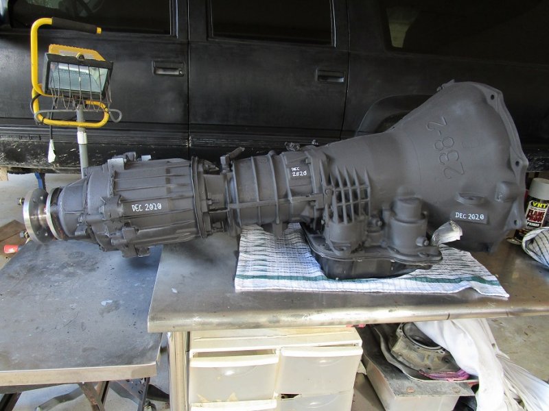

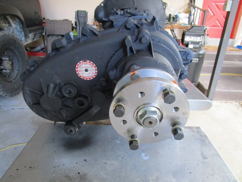

Another option, is a built 48RE 4x4 w/NP241DLD/DHD/C, the "C" will need to be clocked as well as an input shaft change.
My setup is the 47/48RE hybrid, all Billet to include Billet valve body channel plate, Sonnax mods & TransGo 48RE kit, low stall -400rpm Billet converter, Tom Woods SYE kit for T-case, midsize truck trans cooler, slightly longer converter bolts w/NORD LOCKSIMG_0306.JPGIMG_0307.JPG.IMG_0309.JPG

You could almost yank the Titanic off the bottom with that set up!
The 48RE is getting very rare because owners of newer Ram Cummins trucks are converting from the newer transmissions to the 48RE. Yes, some people are going to Allison too, but aftermarket is making it easy but costly to convert a 47RE to a full blown 48RE.

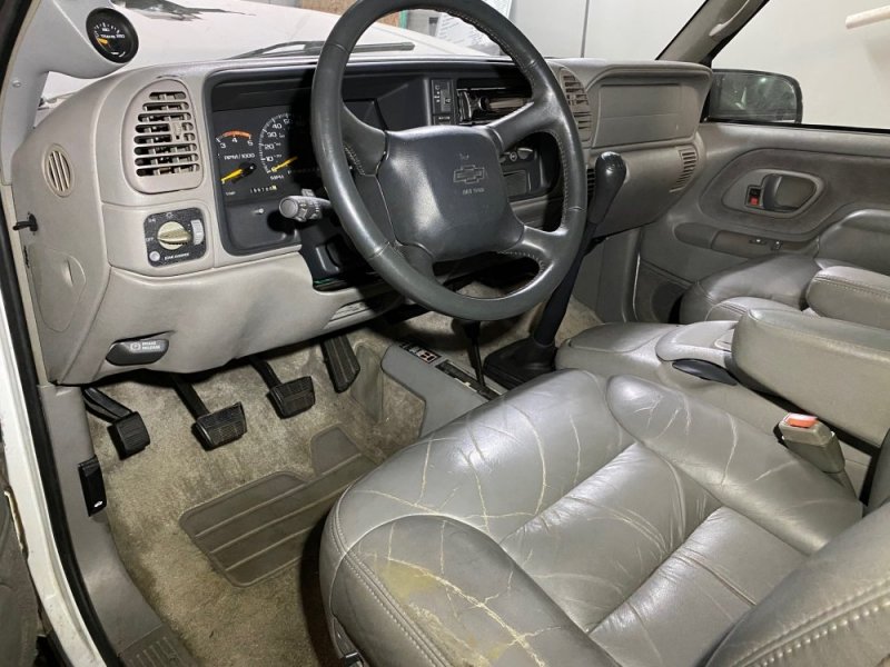

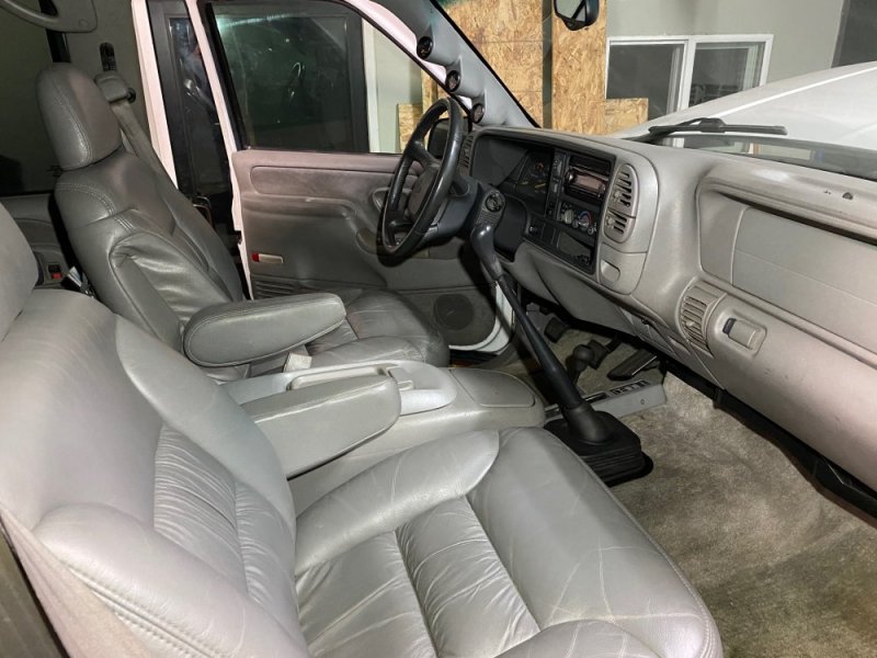

I raided a Pick Your Part this weekend, got the pedal assemblies and column trim, then installed it all yesterday. It's a trip not seeing a column shifter on an SUV. Only things I'm unsure about is the reverse light signal and speedo sensor that runs to the PCM wiring.
The reverse light, do i just splice into an existing signal? I presume the wires are in the harness from the 2 now-unused neutral safety switch connectors.
Speedo, there are 2 wires in factory form: PPL/WHT and GRN/BLK. the diagram i have indicates that PPL/WHT goes to VSS High slot and GRN. Just run those to the VSS, right?
For the clutch starter safety, it looks like the clutch pedal switch is in-line with the brake switch.
Thanks y'all.

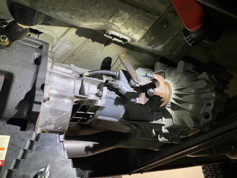

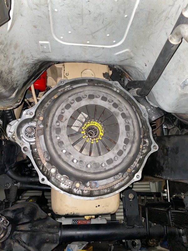

yeah, got the NV4500 and BW4470 in, was hoping to just drill new holes in the frame rails for the crossmember, but it'll be too close to other holes for me to feel safe. new crossmember to be fabbed.

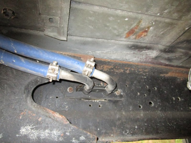

redid the rear heater lines, routed them along the framerail to the front instead of over the exhaust and over the trans like they were with the 6.5TD.

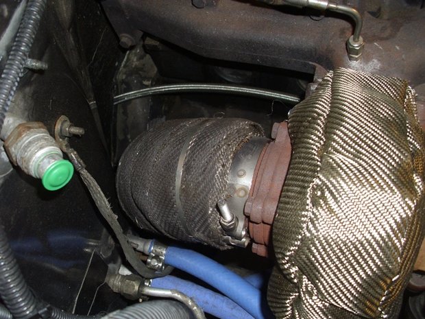

original down pipe was pretty funky and it wasn't exactly easy to remove with the starter on the driverside and the SAS leaf hangers in the way, that will be addressed shortly.
new driveshafts are ordered, redid the interior to accommodate the stick, rewired the back up lights, installed all OEM GMT400 pedal assembly, removed the column shifter, replaced with proper column cover, removed the auto trans cable.
The 4500 came with a pretty fresh stage 1 South Bend Clutch.
Master cyl is from a chevy, mated to a dodge slave cyl. went together great.

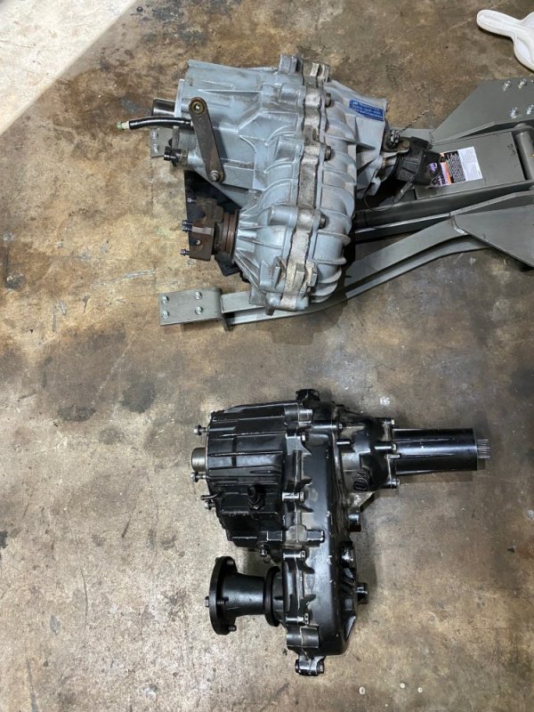

The size difference between the NP241C and the BW4470 is impressive.

A 1st gen Cummins 2wd 4" OD downpipe attached to a mid-mount exhaust manifold will tuck down between the bottom two bolts of trans adapter on passenger side, another option would be a Cummins cobra-head down pipe.
