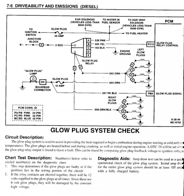

My Bad! I was confused over codes. :facepalm: :facepalm: :facepalm: Is the code 29 gone? Any other codes aside of 36?
DTC 29 - Glow Plug Relay Fault
DTC 36 - Injection Pulse Width Error (Time Long)
You're good! Code 29 is gone. 36 is still present. By the way, did you get my message about the k47 airbox and other parts?
