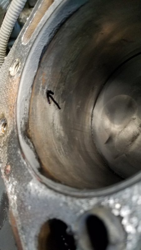

Mine cracked inside the #8 cylinder. My year (98') was more prone than yours. Mine too had the same symptoms which is why I mentioned it. It would start and run rough for 10 seconds or so after leaving it overnight. And, like yours sometimes it wouldn't do it at all. I have since determined that the reason it would sometimes not run rough, was because the piston would stop on the crack and in a sense plug the crack. Of course you can never tell where the piston would stop. I'll include a pic of my crack in the #8 cylinder. Once I pulled the head the piston was low in the cylinder, there was a bit of coolant on top of the piston and the crack had what looked like perspiration. So it wasn't a huge crack. I drove it for about a year til finally it was parked for 2 weeks and when I went to start it, it hydolocked on me. When I pulled out the glow plugs and cranked it, it blew coolant out of #8.

@Wreckinball67 sux about the #8. Yours cracking so high in the cylinder is proof for some of the hummer folks on here about the “at risk block” thing being wrong. There is a theory that a bad casting spot was the cause for the #8 cracks, but most happened about the middle of the cylinder and they blamed it on a casting issue for that 1” area.
Truth is both cylinders 7 and 8 have issues there- note ring gap, piston to wall clearances, etc. The #8 goes more often from the imbalance of flow from the older waterpumps, and the coolant eddy currents in the block.
If you take measurements of that damaged cylinder, the issue of warping stands out pretty good.
Temps kept always below 220, and almost always below 210 made all the difference in the world in the fleets.

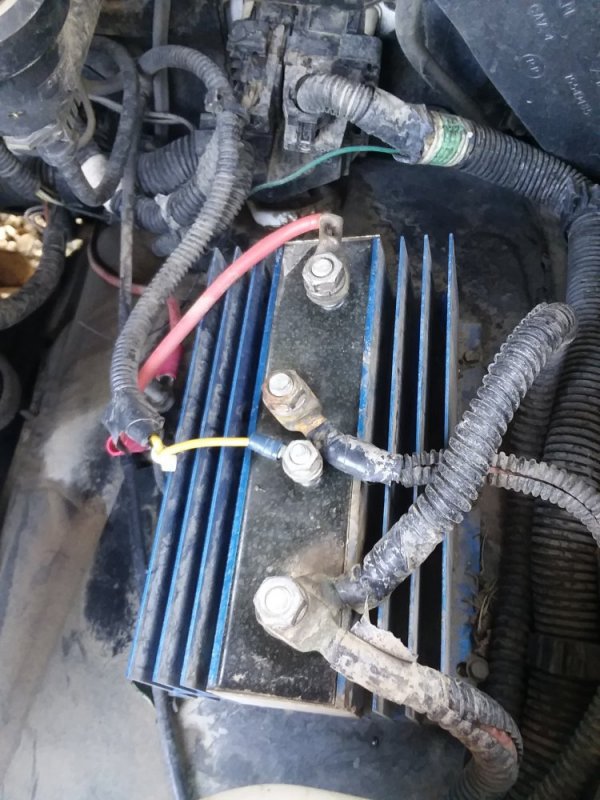

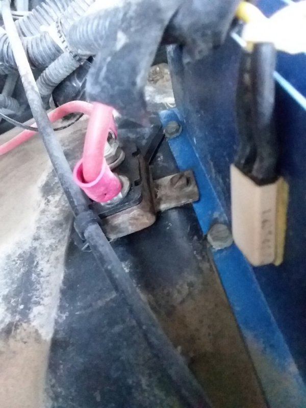

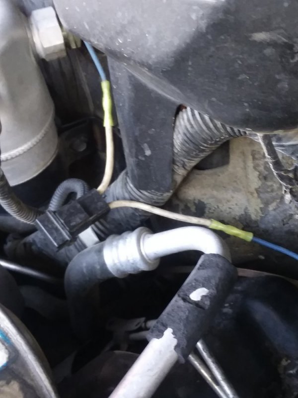

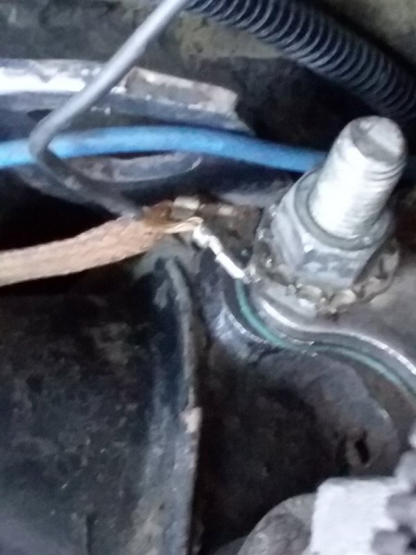

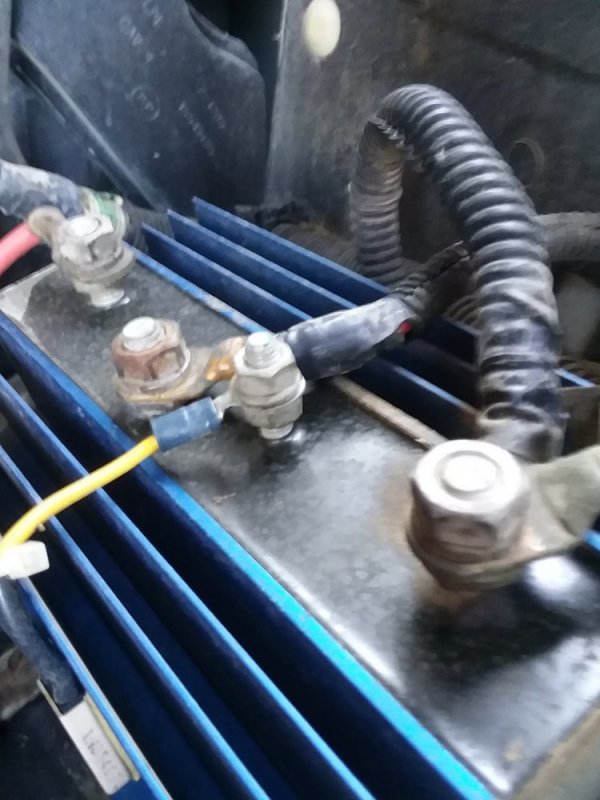

I've attached pics of the ground thing I was talking about as well as what i think is the aftermarket oil sending unit relay.

Oh okay good to know on the battery and fuse thing. In the second to last pic, the wire to the ground is showing towards the metal thing that goes around the bolt. That might be an issue. Noticed it the other day. As far as the ECT goes, there was no change in anything when I unplugged it. Same with the Baro and MAP sensors. Just drove the truck about 6 miles and it ran fine like usual. But it had the usual intermittent check engine light at certain speeds, mainly about 45mph. If I accelerate or decelerate, itll go off like usual. Cruise control will work for a few seconds then the truck will buck and cruise control will go off and check engine light will light up then go away after a few seconds. Done that since I bought it but it was only pulling code 29 and 31 before. And Will L, I only have two batteries. How would I eliminate the battery insulator? What is it even there for?

I really doubt the isolator is the cause of you issues, so maybe solve that first. Keep following AK DIESEL DRIVER’s lead here. Make sure to hit all the steps and report back.
I know I unplugged the one in the crossover. The other is for the gauge. Had the same issue recently on my gasser. I'll definitely clean up the grounds and report back to yall. Thanks for the info! And Will, how much do those battery cables run? Are they side or top post?
