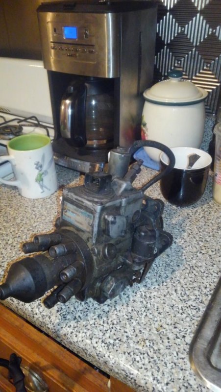

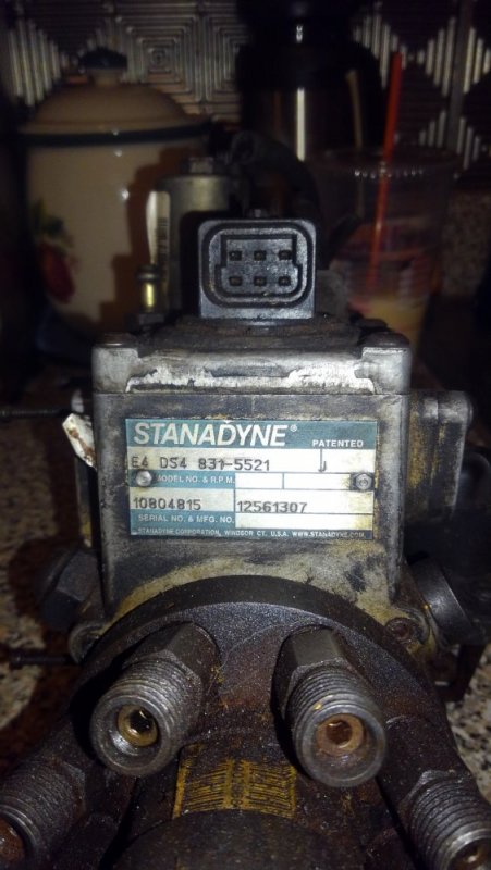

I think I hit the jackpot on something today.. a buddy of mine was cleaning out his garage... And had this pump sitting on a shelf... He said a friend of his a handful of years ago had bought this pump brand new and ask him to install it... He installed it and it did not fix the problem so he took it back out and put the original back in....evidently he had told the guy he didn't believe it was the injection pump up front but the guy was insistent so he was happy to take his money and show him that the new pump would not fix the problem... Turned out to be the crank sensor being bad... The long and short he knew I had a 6-5 and asked if I wanted it I said hell yes he said good put it in your truck and get it out of here I'm tired of looking at it... JACKPOT!!! Of course I just thought of something as I'm writing this...are all the IP the same or do they differ year-by-year? my truck is a 97 OBD2..f-vin

A couple of years I think... I was wondering if I could send it back to standadine and have it tested

Good find! Yeah worth fixing yourself or if it doesn’t work with your rig, others here can put it to use. I have given away a few ds4 injection pumps here for folks to get redone or do testing with.
Now if ya find an old not ran db2 pump- hollar to me!! Haha!
