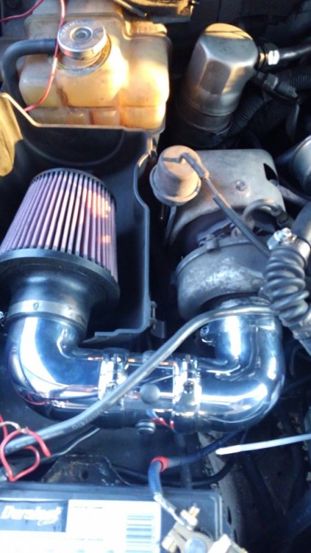

I took out all the piping from the turbo to the air filter..ran a piece of hose from the e.g.r. valve out the bottom of the truck..and ran a 3" pipe (Spectra brand) from the turbo in to the air box (looks kinda like a horse shoe) and put a k&n cone style high performance air filter with 3" inlet on the end of the pipe... Major power gain and the turbo spools real nice...just make sure you remove the fender snorkel and and make sure you keep air box cover on...and you've probably heard this before but keep a couple of extra pmd's in the truck you're going to need them..

Save you some money here and get the same results: Return the K&N air filter (or oiled clone of the krap filter) for a refund and just run without an air filter. Your rings will eat just as much dirt, no worries of the K&N quickly clogging up with what little dirt it does stop, and no worries about K&N refusing to warranty anything because it's your fault not only for using an inferior air filter, but, clearly no one has ever serviced or maintained a K&N air filter properly according to K&N's claims department. Once you dust the rings from poor filtration, holes or cracks in the intake plumbing, it's game over no matter what filter you run afterwards. One aspirin sized tablet of dirt is said to be the equivalent of 75,000 miles of wear.

That's weird.. I've never had a prob with them on other trucks...what kind of filter you suggest?

If you can find the OE heavy duty system (known by its RPO code of K47), that is the easiest to drop-in and works great. If you can get all the plumbing up to the compressor, that is a bonus. But at a minimum get the box and connector to the fender (so that you get cold air).
S&B is known for working well with the 6.5 as well and IIRC Leroy sells them.
Toward K&N, briefly moved my vehicles over to their oiled filters. The gassers saw no noticeable change from their OE paper filters. The DI diesel got ~2 mpg instant benefit, but my mechanic pointed out where the filter had creases from where it collapsed under heavy load.
Now I run paper filters. In the Burb, I used the cylindrical NAPA Gold one in a K47 box.

Long story short: Running K&N I have had enough dirt go through the filter to make a build up of dirt on the Idle Air Control valve. This caused the valve to be thicker than the ECM thought and resulted in attempted idle at 450 RPM. It stalled several times and simply wouldn't idle. Seen several other trucks including Ford with the same problem. On my past love of a Jet boat - boats run flame arrestors only - the oil would drain to the bottom of the K&N filter and leave the top white. Aka a flame arrestor did a better job with less mess.
Problem isn't defined by total engine failure alone, but, the grit going by shortens its life.
We can argue oil all day long. The real diffence is the best filters. Oil failure can take an engine out. So can a filter failure.

Which sucks because with that filter and that pipe it's the best the truck has ran since I've owned it ...spools up loud.... Tons of power.... And better fuel mileage.... But if it's going to tear my engine up then I guess it's got to come back out...cuz if I blow that engine whole trucks got to go to the scrap yard cuz I can afford a new engine..lol
