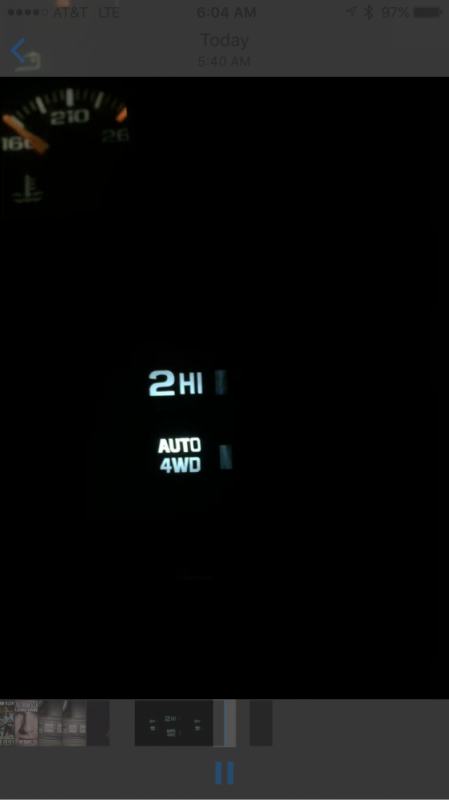

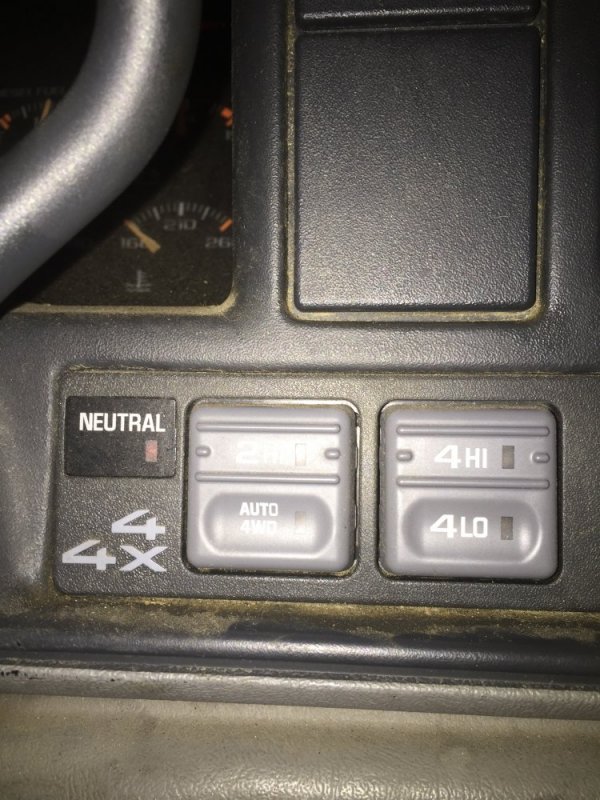

So I had the Suburban parked out back and it rained. This morning my wife went to take it in for alignment and got it stuck where it was parked. I could tell by the pics she text that 4wd was not working. I got home late (7:30) and checked on it. The right half of the transfer case shift selection switch (4hi and 4lo) is dark and there is no indicator light for 2wd on the left side. This is post dropping the transfer case to pull lower control arms for new bushings. I did disconnect the plug to the 4wd actuator while doing that. Any ideas or suggested trouble shooting?

Right half of the switch is dark, so I guess the first thing to check is the fuse for 4wd.
Here's a pic of the switch this AM...and of the whole switch using the flash.

That is the np-246 full time case(theres 2 different push button cases). Switches were alot of problems on those, but the encoder motor for the transfer case also gives alot of troubles. Gotta find out if it's even trying to shift or not. Check the fuses, if one is blown, see if it blows as soon as you replace it. If it does, un0lug the encoder motor and see if it blows right away again. When the fuse instantly blows, it's normally the actual shift motor in the encoder motor assembly that's failed. If it's shifting at the case, but not the front axle, then you're going to have to get a test light and check the cad motor. The black plastic ones normally don't fail, hut they do every once in awhile.
In the light of day, the problem was simple. No burnt fuses. Checked the actuator on the front axle and the wiring plug had pulled out. I did not get it locked in place.

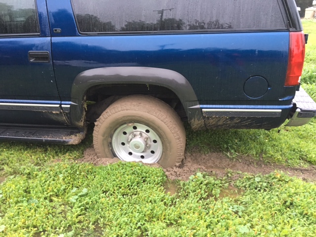

Basically, I parked the '99 Suburban in a low spot in the yard. The plug to the 4wd actuator had come loose and she buried it trying to get it out. With 4wd, I was able to pull my 27' fishing boat out through the same area and get it towed to a mechanic. My wife left huge ruts back there.
