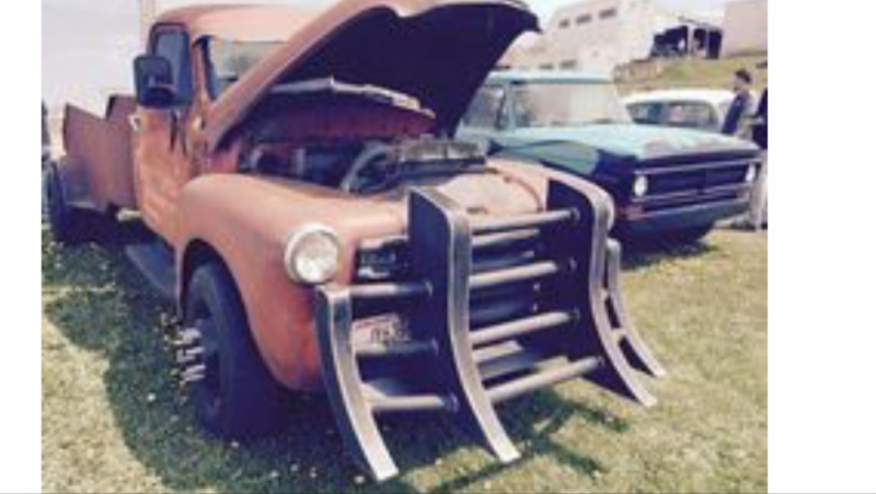

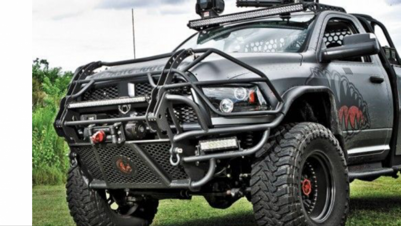

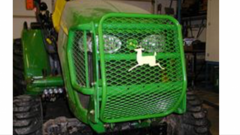

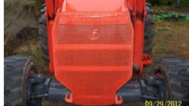

HUGE brushgaurd. Lots of pipes across the front end and some large pieces of small hole expanded metal...
Pics to think about:
Couple tractors with the right mesh, and some options from flat faced to match To the obscene on the dodge..
But the best one here is the old Chevy. Add that to the front with the mesh from the red tractor behind it and I promise no one will notice the grille/ headlight abortion gm made.5590955910559115591255913
