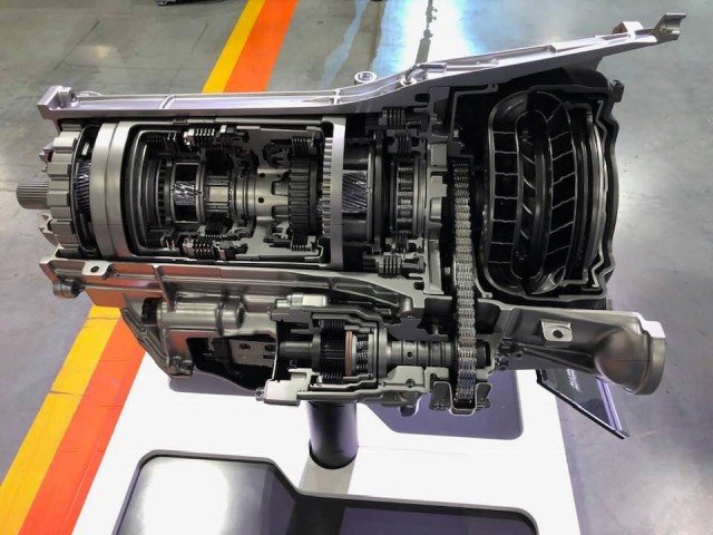

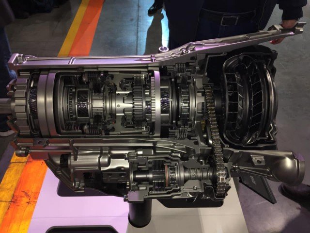

It's NOT an ALLISON transmission. It is an ALLISON APPROVED/CERTIFIED transmission designed by GM/FORD, and GM paid ALLISON to test and certify so they could slap the ALLISON name on it as a selling point. Only the 4500/5500 get an actual ALLISON trans which is still a 6 speed. This trans is the same as the 10r140 that FORD is putting into there new 2020 HD truck.View attachment 55781

I wonder how the 10 speed tranny will hold up against the 6 speed. Will gears be just as strong? Will the more powerful engine eat up the metal gears? Max RPMs on highway in 10th gear?
Nobody knows yet. The 10r140(Ford)/10l100(GM) has yet to be seen by the average joe. It is a little concerning that GM stayed with the allison 1000 6 speed for the 4500/5500 that they're building with INTERNATIONAL(Navistar's way of getting back at Ford for dropping them for engines). I did read the new transmission will be able to shift MUCH faster than the allison, and unlike the allison it can skip over gears downshifting.I wonder how the 10 speed tranny will hold up against the 6 speed. Will gears be just as strong? Will the more powerful engine eat up the metal gears? Max RPMs on highway in 10th gear?
If they do in fact run 3.42 gears, they should drop right down in 10th gear as the other 10 speeds have a .64:1 10 the gear(or 3rd OD gear). They also have a 4.71 1st gear with lockup in 1st, so if they run those ratios, it should pull right out. GM has also eluded to saying this one will have full power available in all gears(unlike the current model that is torque limited in 1st).
