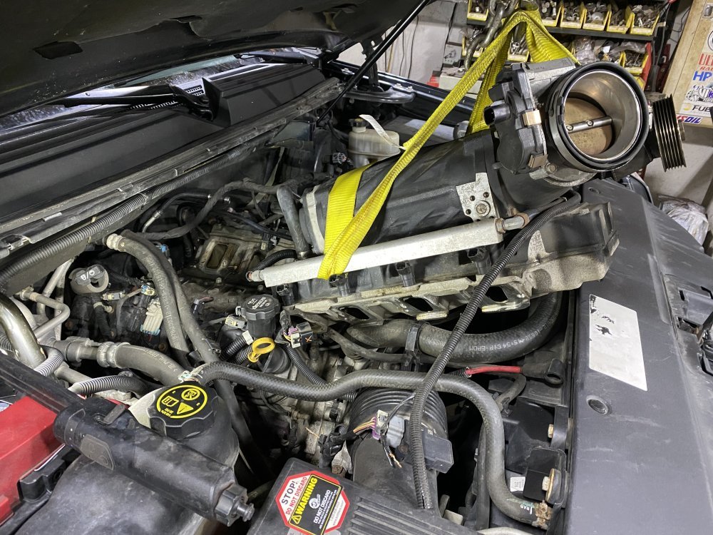

The oil pressure sensor went bad. I spent over an hour trying to remove it. I had an OPS socket that I had already done some trimming on so I could reach the sensor under the intake on a 6.5…… so I kept trimming it and trimming it until it would clear the supercharger’s intake and slide onto the sensor. By the time it would finally slide on, it didn’t have enough meat to grip the sensor. Neat. Ended up I had to remove the supercharger just to change the sensor.
While it was off, I thought it was interesting what the ports on the supercharger were shaped like. The ports in the heads are rectangles. You can see the witness lines from the gasket.
