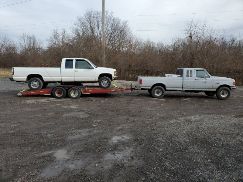

So, I just told btfarm that I wasn't going to do this until I got the truck home, especially since I don't have photos, but here is what I've got:
Just bought a 95 K2500 ext cab long bed manual transmission with a 6.5 that refuses to stay running for $1000. With title!
Had to leave it where it sat since I didn't drive a truck and trailer in today, but plan on zip-tying the clutch pedal and bumping it on the trailer - hopefully, haha.
Per the seller - truck ran amazing for 10 years until 1 day the PO high-tailed it 12+ miles because his wife was in a wreck and ever since it wouldn't stay running. They supposedly tried a new PMD and that didn't work. They diagnosed it as the injection pump - but I'm going to try the pedal (especially if I can find mine from 9-10 years ago.) The oil level was weirdly high and thick. No sign of water in it though. The front bumper was cut off - had a snowplow but didn't look like it. Coolant overflow tank had fluid in it. PMD is repositioned to a bracket on the intake. 223k miles. valve covers look like they've gotten hot. Bumper hitch but not gooseneck.
Says it'll start with a shot of starter fluid. And then run rough.
I'll post pictures when I get them.
VIN: 1GCGK29F7SE222925
Will L has already suggested a few worst case scenarios:
1) Blown head gasket, cracked block or head. Drained and refilled oil and coolant then gave up.
2)If it is not coolant then fuel is the only other thing to raise the oil level with. Injector starts dumping a ton of fuel and it washes down the cylinder..?
I'm hoping for best case scenario - foot pedal or lift pump or clogged fuel filter, hahaha
