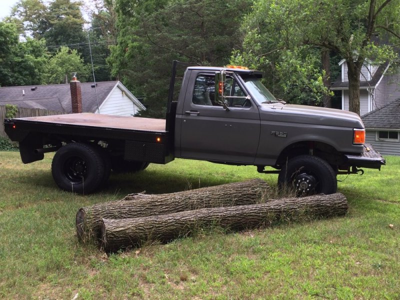

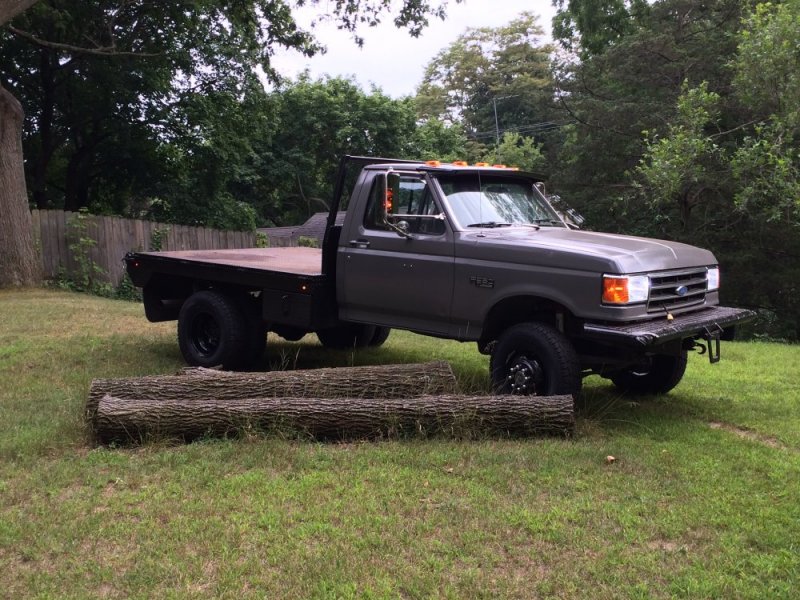

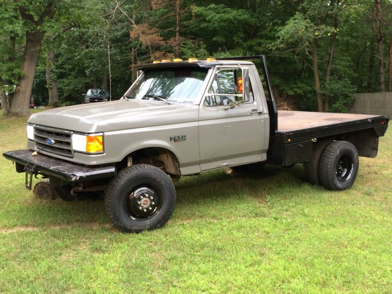

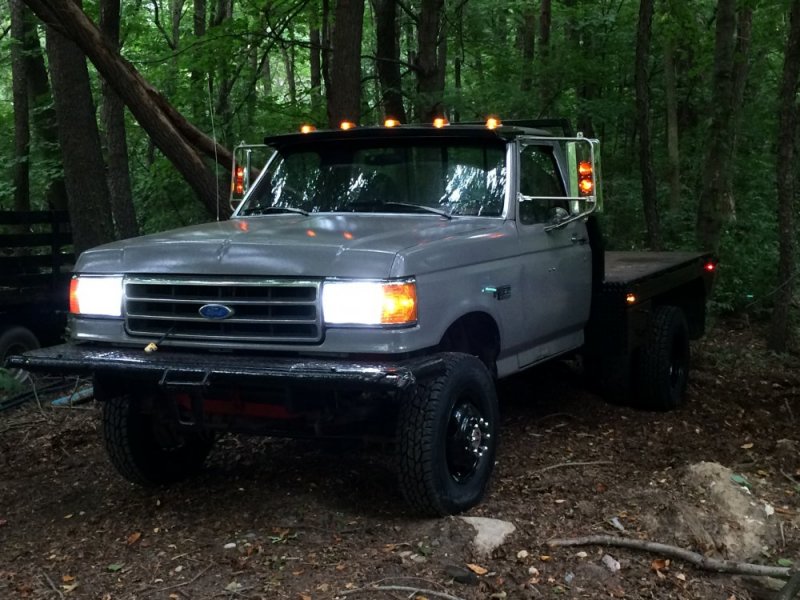

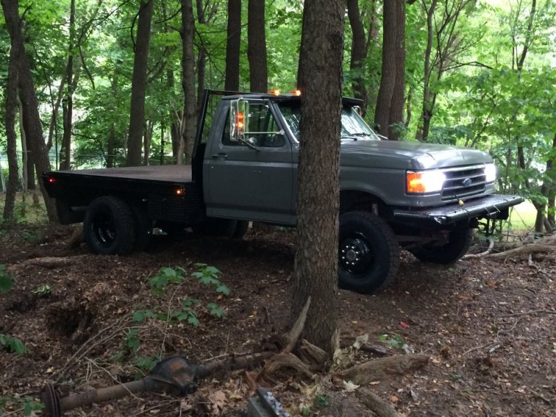

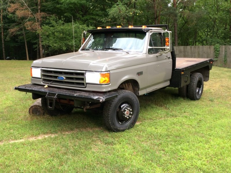

I finally put it on the road last night!! It's fun to drive, but it sure is slow! I'm pretty sure the pump needs to be turned up a touch because it doesn't make any smoke no matter what I do. I'm also going to check the timing to make sure that is correct. It's so slow though - I'm pretty sure our Class C motor home was faster than this thing and I know my 300-powered F150 could smoke it. It also has trouble maintaining speed up hills unloaded so I'm pretty sure it just isn't right. I'll check timing and play with the fuel screw and hopefully I pick up a little power.

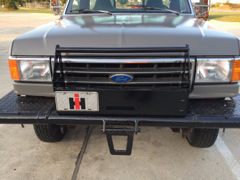

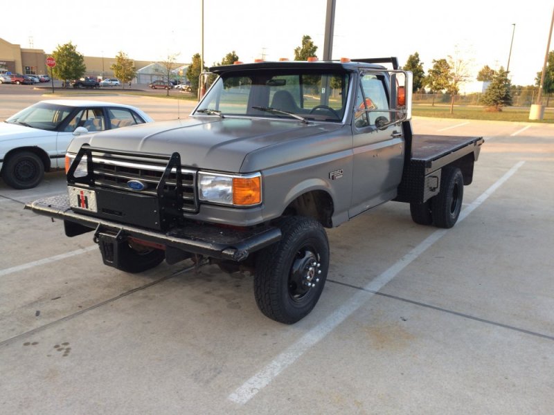

I did a couple things before putting it on the road - most noticeable was the reinstallation of the winch mount on the front bumper. I don't think I'll ever mount a winch to it, but I do like how it adds some more bulk to the front.....plus it gives me a place to mount a plate.
I snapped a couple pics.

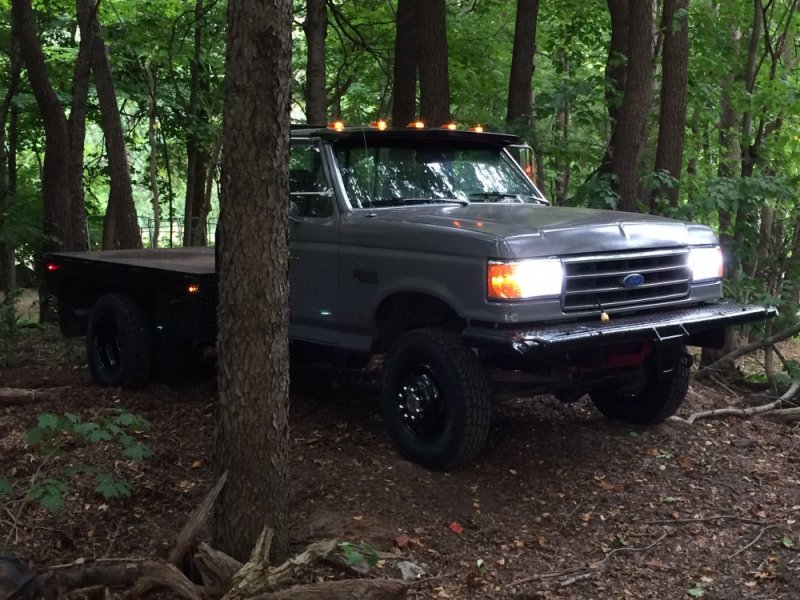

I drove it to work today and got a lot of unsolicited compliments, so that was nice!

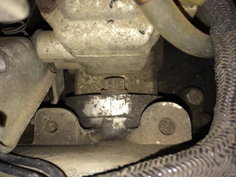

Just finished checking/adjusting the timing. It was at 6* BTDC @ 2000 rpm. I adjusted it to the correct 8.5* @ 2000. It feels better, but no magic bullet by any means. I'll hopefully add a pyro and bump up the fuel this weekend. The timing marks were lined up when I started and this picture shows how much I moved the pump. IMG_9535.JPG

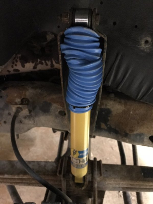

I made a change tonight. This thing rides TERRIBLY. There are some roads that are abusive and one time I was towing my trailer and I thought I was going to bounce off the road......so I decided I had to make a change. I’ve been doing some research on some OBS Ford-specific sites and the consensus is that Bilsteins are the best thing you can do for these trucks. They’re more expensive than the Ranchos I already put on, but it felt like it was becoming a safety issue. I only swapped the fronts so I could see how they would perform with minimal investment and they definitely made an improvement. I only drove it 5 miles tonight, so I’m not sure if they’ll break in or not, but so far I’m pleased with the improvement. To get more improvement I’ll probably need to run dual shocks to tame the ridiculous leaf springs under this thing. I’ll drive it some more and decide if I want to so the backs as well.
Oh and when I took the Ranchos off, they never extended any longer than the length they were while installed. I’m not sure if that’s normal or not, but the Bilsteins were definitely gas charged and NOT fun to install! I think the front end is a touch higher than before, but I didn’t take any actual measurements.
