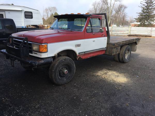

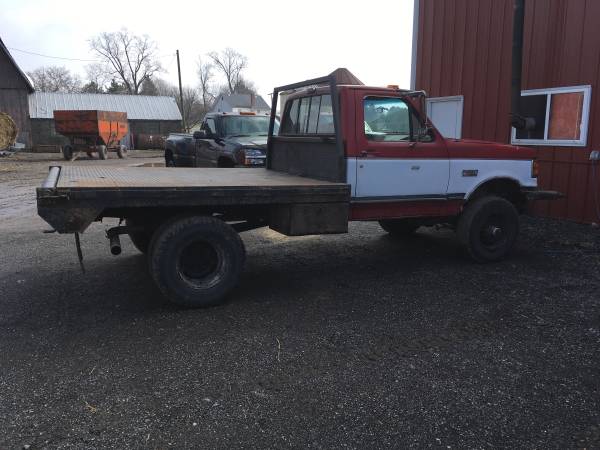

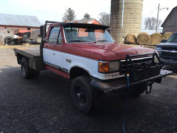

Well, looks like I'm going to be trying my hand at another flavor of IDI diesel! This lump followed me home earlier this week and I can't wait to get it on the road.
I already have a 94 F150 with the 300 six in it. Super reliable truck, very useful, not rusty, just not strong enough for some things I want to do. I have other Ford truck parts so I had thought about beefing it up with a different drivetrain or even dropping the body on another frame, but I just didn't need that kind of a project. This summer I will be removing a retaining wall and pushing the dirt back into a slope, so I will have LOTS of dirt to move. I don't want to rent a dump trailer out of inconvenience and throwing money away on rent. I looked at buying a trailer but dang they're expensive! So then I thought about replacing the F150 with a 1-ton 4x4 dumptruck. I found one nearby, an 86 F350 with a noisy 460 needing repair, but they wanted too much money. As I was waiting for the price to go down I remembered insurance.....I had a 1990 F350 stake truck already. After owning it a couple years, Progressive noticed it was a cab & chassis, not a pickup, so they decided they didn't want to insure it!! My agent found another company that would but it was going to be stupid expensive - so dumb. Well at that point the truck was getting so rusty that it wasn't worth driving anyway so I just took it off the road. Oh and I didn't use the truck for a business, just a heavy duty truck to haul with or do whatever with for myself. Nice. Thanks insurance.

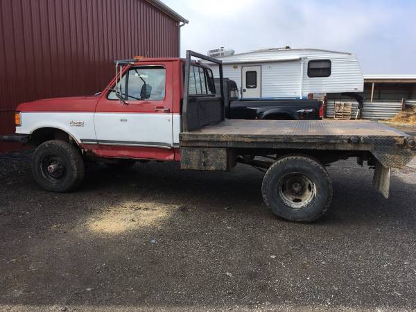

So anyway...looking at the dumptruck I realized it was a cab and chassis and that I'd have the same insurance problem. So I kept looking. Then I found the rig I ended up bringing home. It was a flatbed, which I reasoned I could turn into a dump bed if I had to, but also in the meantime I could just push the dirt off the side when I move it. Also, judging by the axles it started life as a pickup, not a cab and chassis. So I contacted the owner and they were nice enough to send me the VIN. Sure enough, a pickup!!! So I drove the 2 hour trip with trailer in tow to bring it home. It was everything he said it was, just an honest old work truck - perfect. We came to an agreement and I loaded it up. It was a nearly 3 hour drive home. Yes, the Hoe was technically overloaded, but she's all I had that could manage bringing this huge lump home. Luckily it was only in the upper 40s outside - and that helped keep temps in check with my intercooler currently unhooked. Even so, I still hit 1100* going up one grade. Power was never a problem, but I sure hate my torque converter!! The darn thing is so loose at my power level, it's hard to accelerate unless the clutch is locked, and I have to be careful about the timing of the lock so I don't break something when it engages. Anyway, made it home just a little after 10:00 at night and I was very satisfied. She's gonna be a cool rig I think. I hope to start working on her later this week so she can be my new second vehicle and I can sell the F150 to recoup the cost.

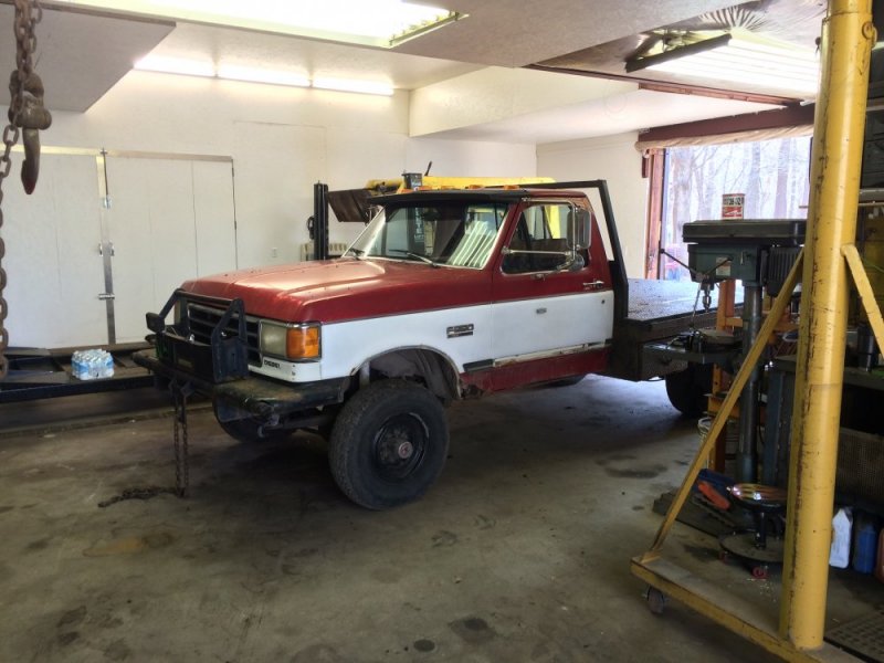

Short term plans:
Fix the mushy brakes. For some reason these F350s have weird brakes. I finally got the ones in my stake truck feeling ok before I took it off the road so I'll swap the oversize master cylinder from that to the flatbed. Then a good once-over of everything else. Probably needs the drum brakes adjusted too.
Fix the starter. He pull started it to show me how it runs, but the starter won't turn it over. He said the truck had been sitting a while and when he went to start it, it wouldn't do it. I found some loose connections, but the starter still just clunks. He said it was a newer starter from Oreilly. It is visually. But I have read that these IDIs have aftermarket starter problems, just like the GM diesels. So I already bought a Powermaster starter to go on it. That will fix it.
I want to fix the AC because it's nice to have that when you're working.
There will be other odds and ends to take care of to make it something reliable and nice to drive, but not much overall. The frame and all of the mounts are rock-solid and that is the important part. There's even paint on the frame still, which is unheard of for older trucks up here. I'll post as I get things done. Some day it will be a tough mother that will be a truck capable of doing any heavy work I want to do. Future upgrades will be: turbo, bigger IP, intercooler, and other upgrades, who knows what all. Should be fun!!

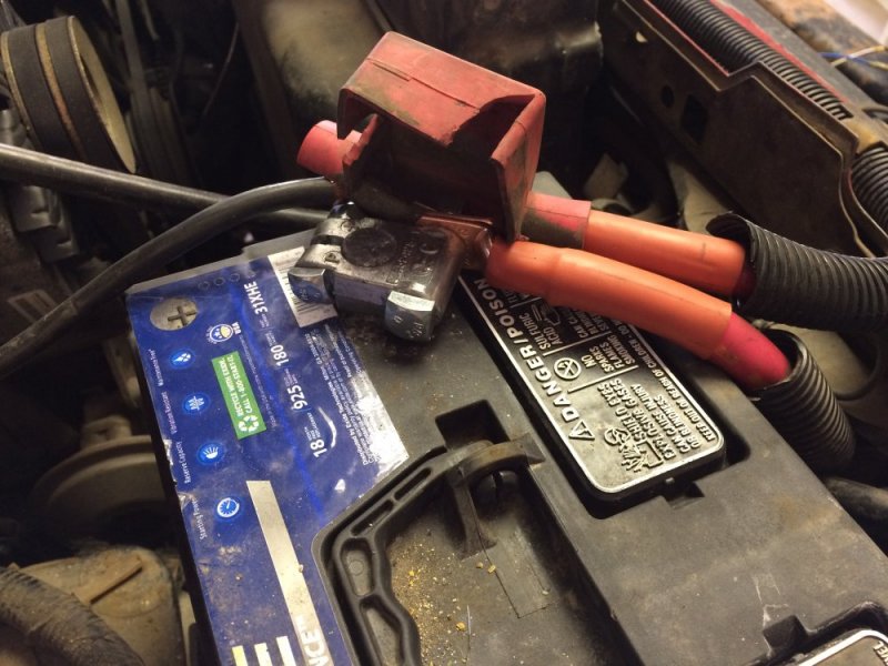

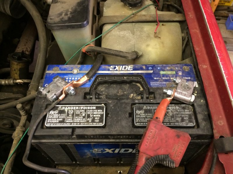

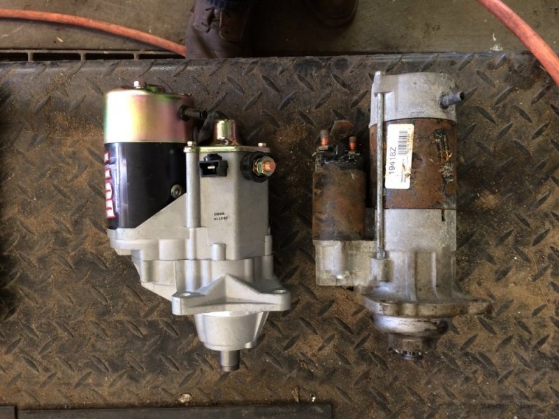

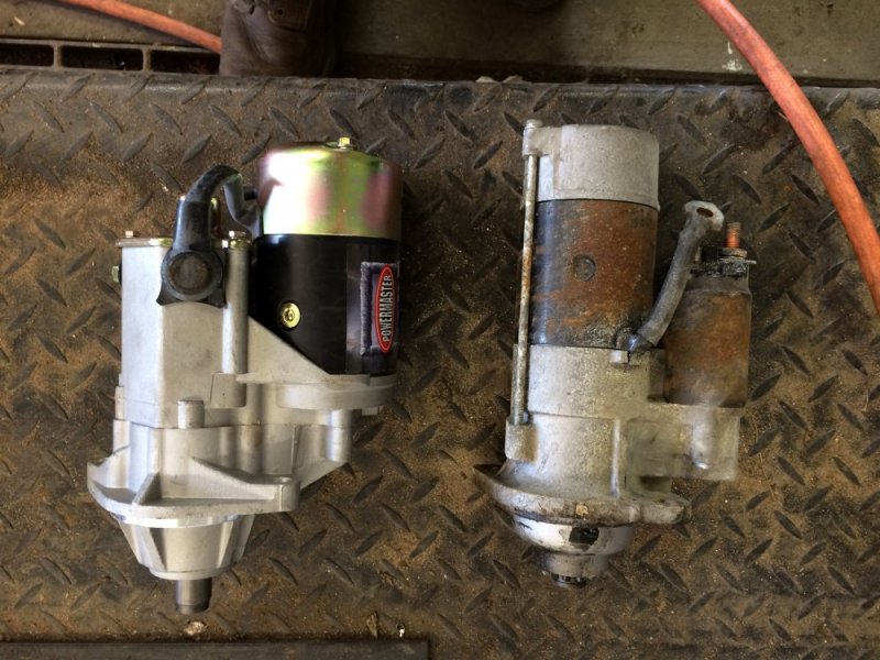

It's alive! I got the Powermaster starter installed today. I also put new cable ends on most of the battery cables. This thing has 2/0 battery cables from the factory! I took a video of the first start with the new starter and cable ends. It cranked slower than I expected and took longer to start than I would have hoped so I'll have to look into that.....EXCEPT after starting it I noticed that I had left one of the grounds off the battery - so it had started on just one battery! Oops, and yet pretty cool too. Of course it was about 80* outside, so that had to of helped. I'll see how it starts on two batteries cold and decide if I need to start looking for air leaks or glow plug problems.
I started it again a couple times after a short drive up the road just to hear the starter. Love that Powermaster power. Again that was with just one battery.
I ended the day starting to do a 3G alternator conversion to get rid of the external regulator alternator on the truck. It boggles my mind that Ford was still using external regulators into the 90s. The alternator I'm putting on is the one that I had already swapped onto my 90 460 before. It's a small case alternator, so not my first choice, but it will be better than what was there before. I'll find a better alternator to swap later - I may even spend thw cabbage to get a Powermaster alternator, we'll see. Gotta get some other stuff taken care of first before I do that.
