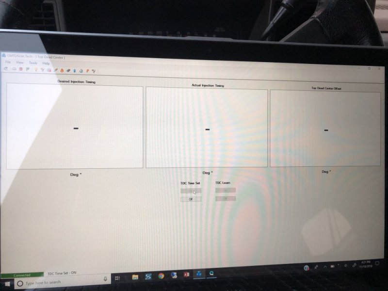

Started up the truck and hooked up the GMTD Scan Tech. Puff of black smoke at start up but engine ran smooth, but still has the misfires above 3200 rpm. DTC codes 17 and 18. Clear them and they come back.
GMTD Scan Tech screen was not reading on injection timing screen. I shut down each injector at 3300 rpm and it did not change the misfires. And no I don’t have the clear hose on the IP but I will install that tomorrow.

Not being able to see what’s up on a scanner doesn’t help verify.
I am not, and I think others are not answering with options right away because everything points towards everything being worn out and we dont want to say live with it or throw a bunch of money and time at it. Kinda hoping someone else steps in with a magic idea here. Either that or Megan Kelly is e-mailing folks to keep their secrets-
Unplug the new cps to see if the optic is working? That could be why you aren’t seeing desired vs actual on the scanner. Usually hard starting is a major symptom, but it could be the cause still.

With the codes still active it looks like the IP, wiring to IP, and with 290K on the chain I agree with @ak diesel driver 's guesses above. CPS and OPS don't agree could be from the chain hammering the valves and bouncing around. I am still shocked and reminded of what any slop in the valvetrain can do to valve stem tips...
DTC 17 - High Resolution Circuit Fault
DTC 18 - Pump Cam Reference Pulse Error
