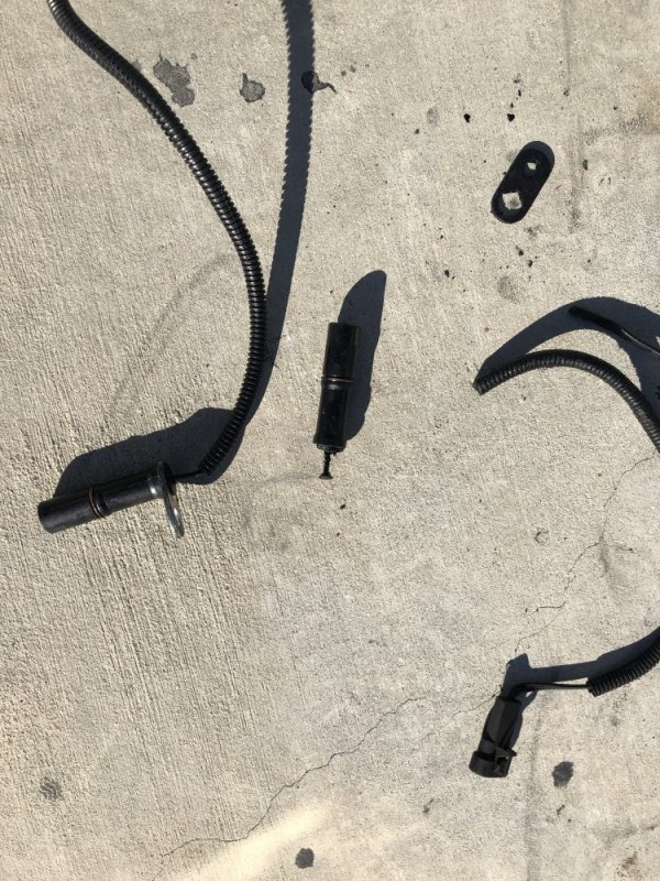

Changed the CPS. Yes it fought coming out, but I ran a drywall screw in it and used a door panel pry tool to lift it out. Did not spend a lot of time on it, but damn that’s a greasy MF’r. Megan Kelly would let me finger bang her.
Did not clear codes, but it started right up. However it misfires above 3200 to 3300 rpm...
