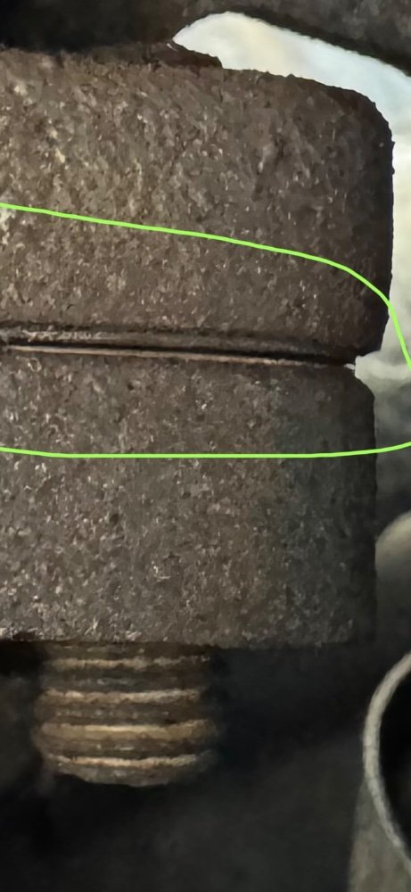

I have a gasket installed that is a two layer metal unit. Might be some kind of heat proof material mixed in.Replacing injectors and let’s just say, I’m having to take it a lot slower these days than in the past. Fortunately, I have the time. I guess it’s a good thing I decided to do them because I discovered that two turbo nuts were AWOL and the two outside nuts came off way too easy to my memory of past efforts. Then, I found, for some odd reason, there were two of the gaskets between the turbo and exhaust manifold.
View attachment 98507View attachment 98508
As for the studs, years ago, when I was swapping out ATT, Super 84/86, GM-8 and ‘Hurricane 7’ (GM-8 with modified turbine and compressor wheels) turbo’s for comparisons, I had replaced the studs in this Hurricane 7 and failed to realize how short they were. 35mm in total length but only 20mm after shouldering the stud in the turbo.
I replaced them with similar ones in the picture that have better threads on the turbo side.
There’s been noticeable oil weep on the return hose and other spots. Turbo weep is from three of the compressor housing bolts being loose and the other seems to be the upper intake gaskets being reused too many times, no squish and cracked. i’ve got extra gaskets and I retightened the compressor housing bolts and Turbo Master stud nuts.
Anyway, I have the passenger side injectors in and will do the driver’s side tomorrow. Unless things are an emergency,(proverbial/Biblical “Ox in the Mire”) I don’t wrench on Sundays.
